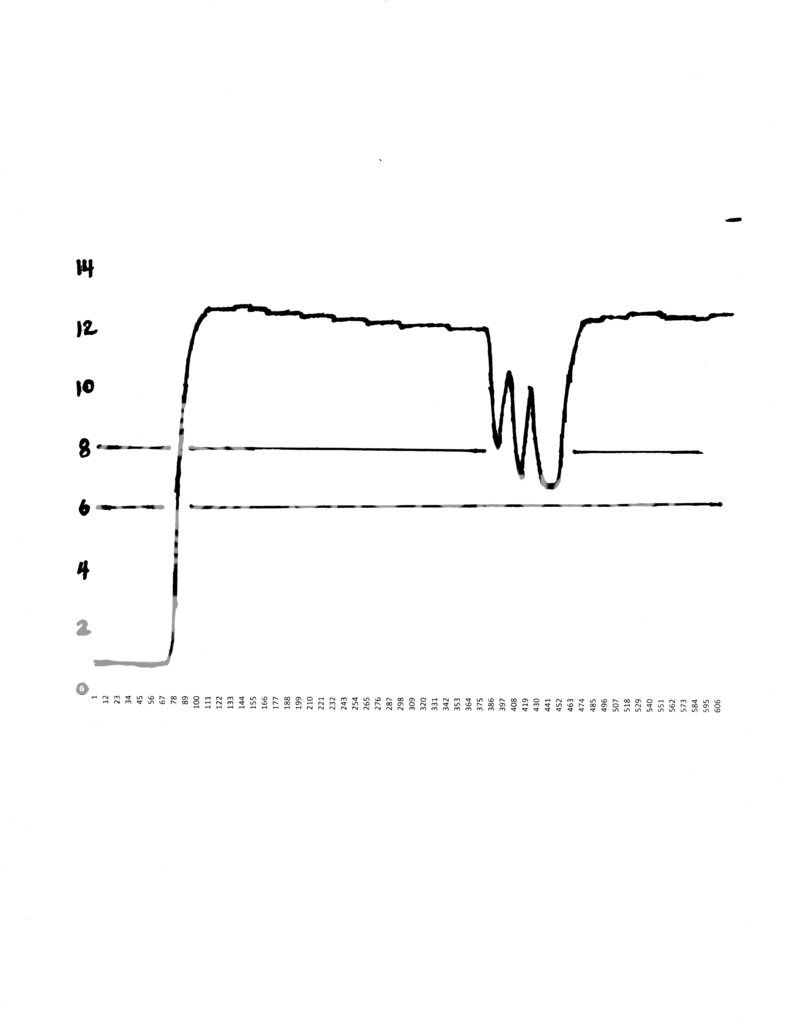

Mike, I'm getting a little better at reading this spread sheet. It looks like my first start voltage in the morning is about 12.1 volts. It drops to about 6 volts as I start, then slowly increases to about 13.8, where it pretty much stay throughout the flight. A warm start also starts at a little over 12 volts, but only drops to about 7 volts, probably due to a quicker start. Does any pf that help?? Tom
THIS RELAY is not the one used in the AV-50002, but is probably similar. If you look at the specs, it will pull in with 8 or 9 volts, but will not drop out until the voltage drops to 1 or 2 volts. It is unlikely that aircraft voltage would drop low enough to cause the relay to chatter.

6 volts is too low. A review of my data logs for my 5-6 year old battery show the bus has never gone below 10.5 volts on start. I would suggest a battery load test before going any deeper into the AV-50002.
Joe,
Yes, I agree with you. A voltage drop to 5.5 volts does not fall below the dropout threshold, its not even close. But the relay appears to be dropping out, but only under starting loads. I don?t know what Van?s is using for a relay in the Skyview. My thought was that they may have changed to a solid state relay, and these have vastly different characteristics.
Tom, regardless of whether this turns out to be the ultimate solution to the chattering problem, voltage dropping to 6 or 7 volts during start sounds abnormal. Probably indicates either a bad battery, or a high resistance connection in one of the connections between the battery and the starter. If it was me, the first thing I would do would be to hook up a known good battery and repeat your tests.

I agree with Mike and John that 6 volts is too low. However, can the SkyView data be trusted? I doubt it. My D-180 records data at the rate of once per second. The SkyView would have to record data every few milliseconds to catch the voltage at the low point. During the first second of starter motor operation, the voltage is constantly changing. It takes expensive instruments to capture that data accurately.
I agree with Tom. If there is a problem with the battery or contactors or their cables, then why does the engine ALWAYS start just fine when the spar-pin override switch is held in? My guess is that the AV-50002 Ignition and Start module is defective. But why guess when the starter circuit can be tested for voltage drops? Substitute a heavy load in place of the starter motor, then measure voltage drops along both the positive and negative parts of the circuit. The heavy load should be connected for a short time period to prevent wires from overheating and to prevent the battery from being discharged.
Let's see if I can post this picture of my graph. This will be a miracle if it works. After I made the chart the image was very light, so I darkened it with a sharpie, but the graph is accurate. You can see the slow decline in voltage while waiting for the Dynon to come up. The you see the start. Looks like 3 compression strokes, then the start, and the voltage rises.
Tom
