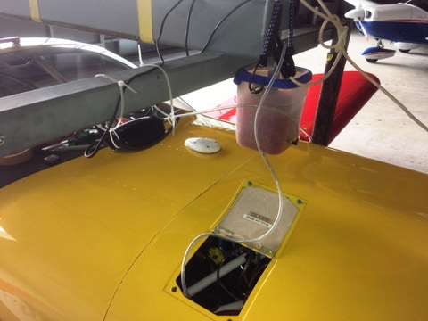

I built a closed loop version to use on the -10 while it is down for upgrades this winter ... it has been running 24/7 since early Nov, connected to the oil filler neck and the breather. I have a gallon of dessicant beads.
It has been very humid (lots of condensation with all the propane we've been burning) and none of the dessicant has even changed color yet. My guess is that this is because it is circulating a pretty small volume of air, and once dried it stays that way.
Makes me feel better about the engine downtime.

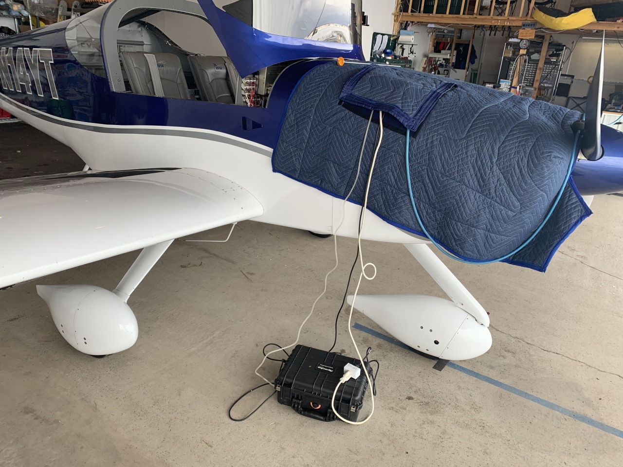

[Edit/Update:12.23.23 Implemented a 20l/min purge with ambient air then a 60 min run with 2.5 LPM desiccant air. N2 for the purge should eliminate oxygen, water and that should to it for a while - how long unknown. I would do that if nitrogen was available. Currently investigating molecular sieve to replace silica gel - initial results (20F ambient) show -20F dew point, much better than silica gel. ]
A PCV system could all but eliminate this phenomenon but it creates more serious issues than it solves.

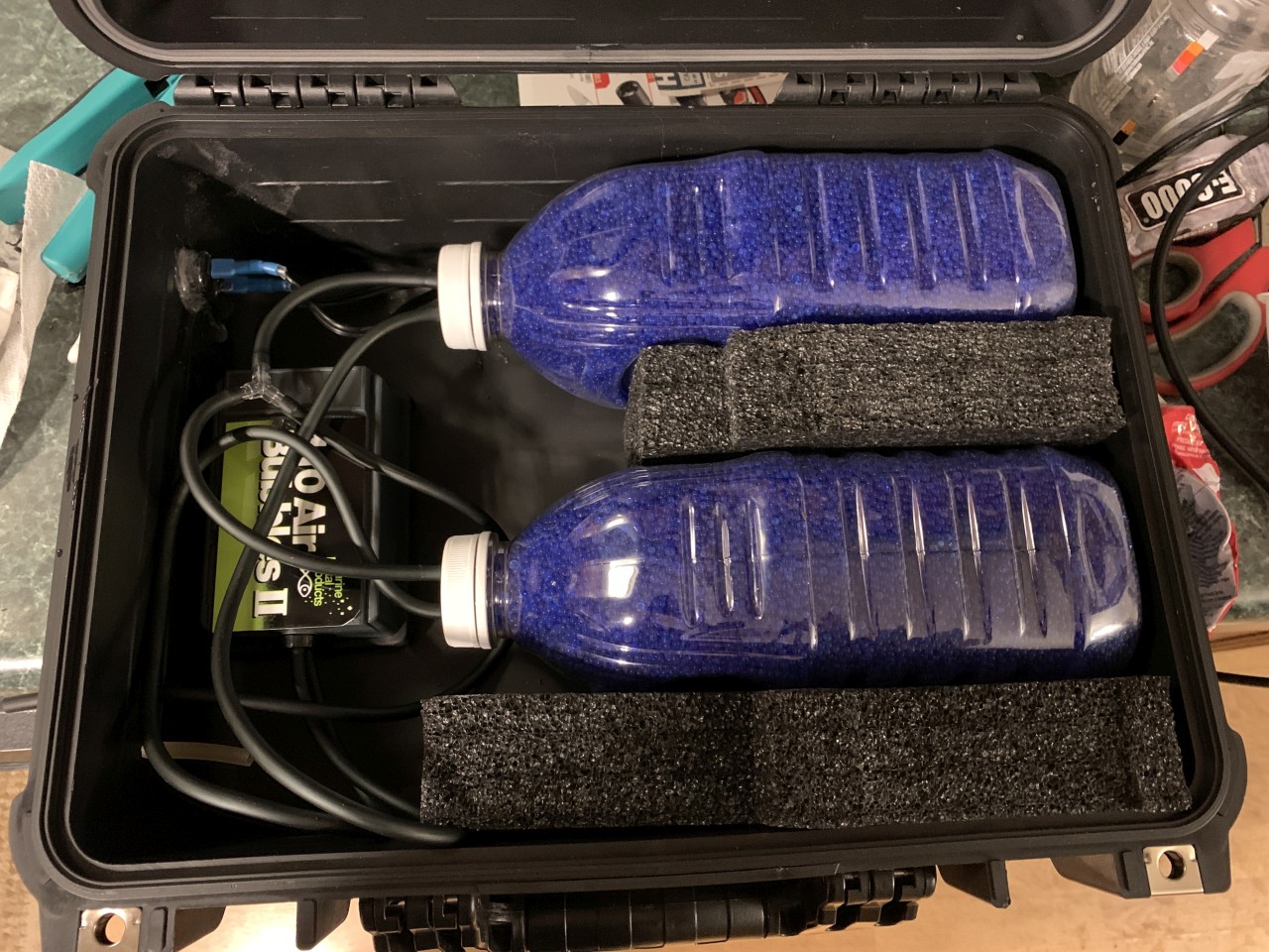

I have two recirculating dryers for my IO-360. One for drying the crankcase, and one for the cylinders. The one for the crankcase recirculates air between the oil filler tube and crankcase breather tube after passing through a canister filled with silica gel, and the one for the cylinders recirculates air from the exhaust into the air intake. The crankcase dryer has a fan connected to a timer which operates for about an hour per day. The crankcase one, of course, requires you to rotate the prop a few turns to move the air. Not a problem as I am at the hangar almost daily. The photo shows both dryers hooked up.

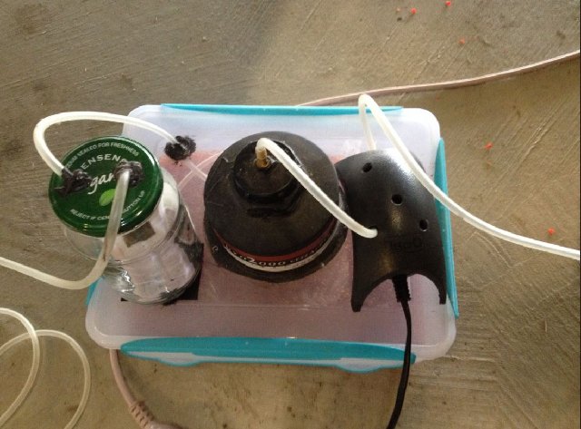

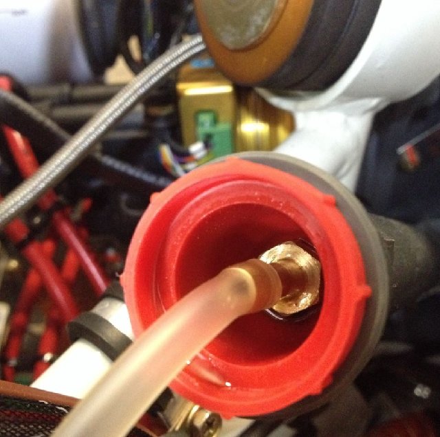

Hi All,
I've had some questions lately on my dehumidifier system that I installed when I first hung my engine and based on my experience with it over the last year, so I thought I'd post a few photos etc. to explain things.

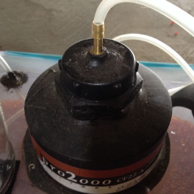

Mine is a closed loop system. This is pretty critical, otherwise you will saturate your desiccant very quickly. It generally keeps the air at 10% or less humidity inside the crankcase. You won't see corrosion occurring at this level, even on unprotected steel. I've got 2.5kg of methyl violet (orange) desiccant in a 6 liter container as my drying medium. The cobalt chloride blue desiccant kills you, so I don't use it. The container has a silicone seal around the top and clip-lock lid to keep it air tight.
At the top of the box is a respirator filter mounted to filter any dust out of the dry air before it is drawn into the engine. I used a respirator filter for this because it was something I had laying around unused that didn't fit my mask. I just found a cap that approximately fitted one end, then used some sikaflex polyurethane sealant to keep it air tight. There are some barbed brass fittings screwed into a hole I drilled in the cap so I can attach the air transfer hose. I cut an approximate hole in the lid of the box for the filter to draw air through, then sealed around the perimeter with sikaflex. The air is pulled out of the filter into the fish tank pump. A fish tank pump contains an oscillating diaphragm that normally pulls air from the body of the pump. You need to find this input port to the diaphragm body, then drill it out enough that you can stick the hose into and seal it in place. The other holes in the pump body are just to ensure that the motor stayed cool as you have re directed the air that would normally circulate over the internal parts everytime the pump oscillated. Probably not necessary given that the pump is only 2W, but I didn't want to find out that it was the hard way. The pump size is not really critical. Once the engine humidity is down to the baseline level, it only takes a small amount of air circulating to keep things at a low humidity level. The pump I use pushes 50 liters per hour and costs less than $5 per year to run. The only upside to a bigger pump/hoses are that they will reduce the moisture level faster after a shutdown, however it is totally unnecessary to have a large volume of air recirculating through the engine. After shutdown, my system can reduce the humidity in the engine at a rate of 2% per hour.
The air is pushed into the engine via a plug where the dipstick goes. When the engine is supplied from lycoming it will have a plastic threaded bung where the dipstick tube will go. I removed this bung, drilled a hole in it with my uni-bit, then screwed a brass threaded barbed fitting into the center for the silicone tube to attach to. The exit air from the engine comes out the crankcase breather hole, so you do a similar thing here allowing you to attach a tube. Once you've finished your engine installation and you have your breather tube and dipstick tube in place, you'll need to make respective fittings for these ports. I may put another jar here to act as an air/oil separator to stop my system being contaminated by oil draining out the breather, but thus far I have had no issues.
The exit air from the engine returns via a glass jar. This contains one of those AAA battery operated room temperature and humidity monitors that you can find at your local electronics store dirt cheap (jaycar in my case). It's handy for keeping an eye on things and will give you more of a precise understanding of the humidity level than the coloured beads. From the jar, the air then feeds back into the box, via an "air stone" that sits along the bottom of the box. This allows the air to be distributed along the length of the box before getting drawn up through the beads. This leads me to my last point. If I was to do this over again I would go with a much taller vestle, rather than the wide, flat one I have at present. Currently the beads in the center of the box reach saturation point rather quickly, whereas the beads around the perimeter stay in their dry state. A taller container would mean that the air is being pulled up through a greater number of beads for the same mass of beads, which would ultimately mean that you will be able to go for more starts before you need dehydrate the beads. I have currently only dehydrated the beads once in a year of operation and 6 starts since I first commissioned my engine, but looking at the actual number of beads that had changed color, it was only a small proportion of the total, and only those pretty much directly above the air stone. Based on the number that had changed color, I suspect in the future that I should be able to run the engine for 20 or more starts between dehydration session. My humidity meter would normally sit at 10% (the lowest it will read anyway) but when I found it holding steady at 20% after my sixth start, I decided to dehydrate the beads. The dehydration is performed by placing the beads on a couple of large baking trays in the oven at approximately 105degC for a couple of hours or until they have returned to their orange state. You want the layer in the tray to be as shallow as possible (an inch or less) to allow the moisture to crack off quickly.
In addition to the dehydrator, don't forget to tape off the intake and exhaust ports (or pipe if you have it installed) and insert a desiccant spark plug in the top plug hole of each cylinder. These are available from Aircraft Spruce amongst other places.
A breakdown of the dehydrator cost is as follow (remembering this is AUD which is about twice what it would cost in the US). Some of the smaller fitting (barbs/caps etc) I had on hand.
Aquarium pump and tube $30
6l box $8
2.5kg Orange desiccant: $70
Room temp/humidity monitor $20
Anyway, I hope this answers everyone's queries.
Cheers,
Tom.

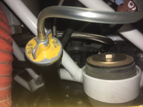

I built a closed-loop fish pump system while my used engine sat before first flight (a total of about 10 months). I also used dessicant plugs. I actually nerded out and built an arduino system that monitored the internal humidity compared with the external. Unfortunately I don't have that data still, but I do know it was significantly drier than the ambient air. About 300 flight hours later and my engine, which now has about 1000 SMOH and 300 STOH has consistently perfect oil analysis. I do fly frequently now, and use camguard.
Chris

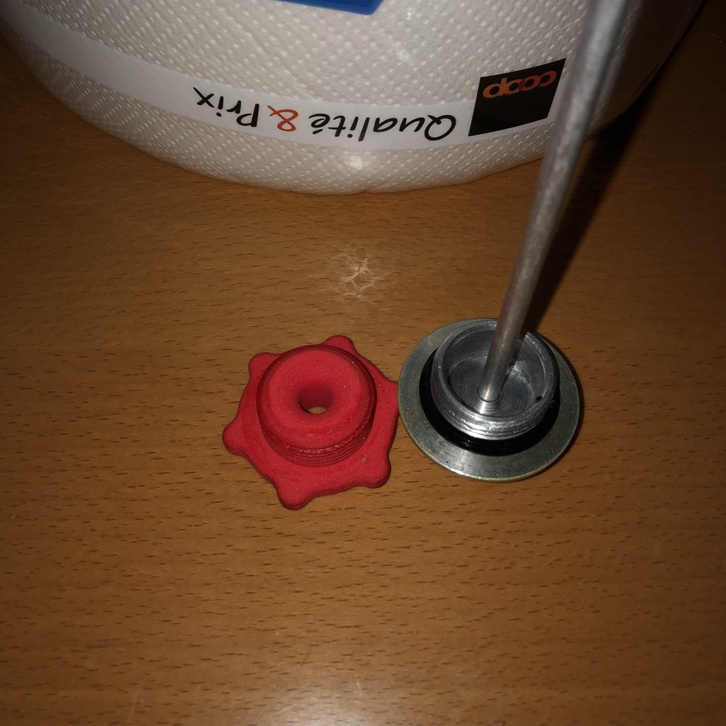

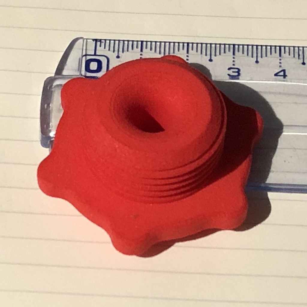

oil filler plug
... If you have a 3D printer, you can make this plug that a friend designed for the oil filler:
https://www.prusaprinters.org/print...NIhYjMy7cGr0DBemezqKXDX9dToSilOCXkm-tOtpId5Kg
Hej Magnus, I ordered this one to be printed by Shapeways, and they tell me it's on it's way. I'll know in a few days I guess if it works.
BTW, I'm using the Black Max (http://www.flyingsafer.com/p-n-2065.html) . I got them to make a 220v version. It's expensive, but if I can get extra time out of my engine, I guess it's worth it.
It seems to work fine, but check back with me in 20 years to see if I have any corrosion in my engine. :)
?If you have a 3D printer, you can make this plug that a friend designed for the oil filler:
https://www.prusaprinters.org/prints...CXkm-tOtpId5Kg?
I have an Ender 5 3D printer and just printed this. It threads on maybe 1 to 1/2 turns then stops. That?s ok for plumbing up a drier system, just be aware it won?t thread all the way down. I haven?t looked in to what the problem is yet.
Fittings
If you figure it out, I would be interested in buying one. I'm building a dryer.

I connect to my breather tube with a piece of PVC tubing.
Of course, the breather tube needs to be clear of the exhaust.

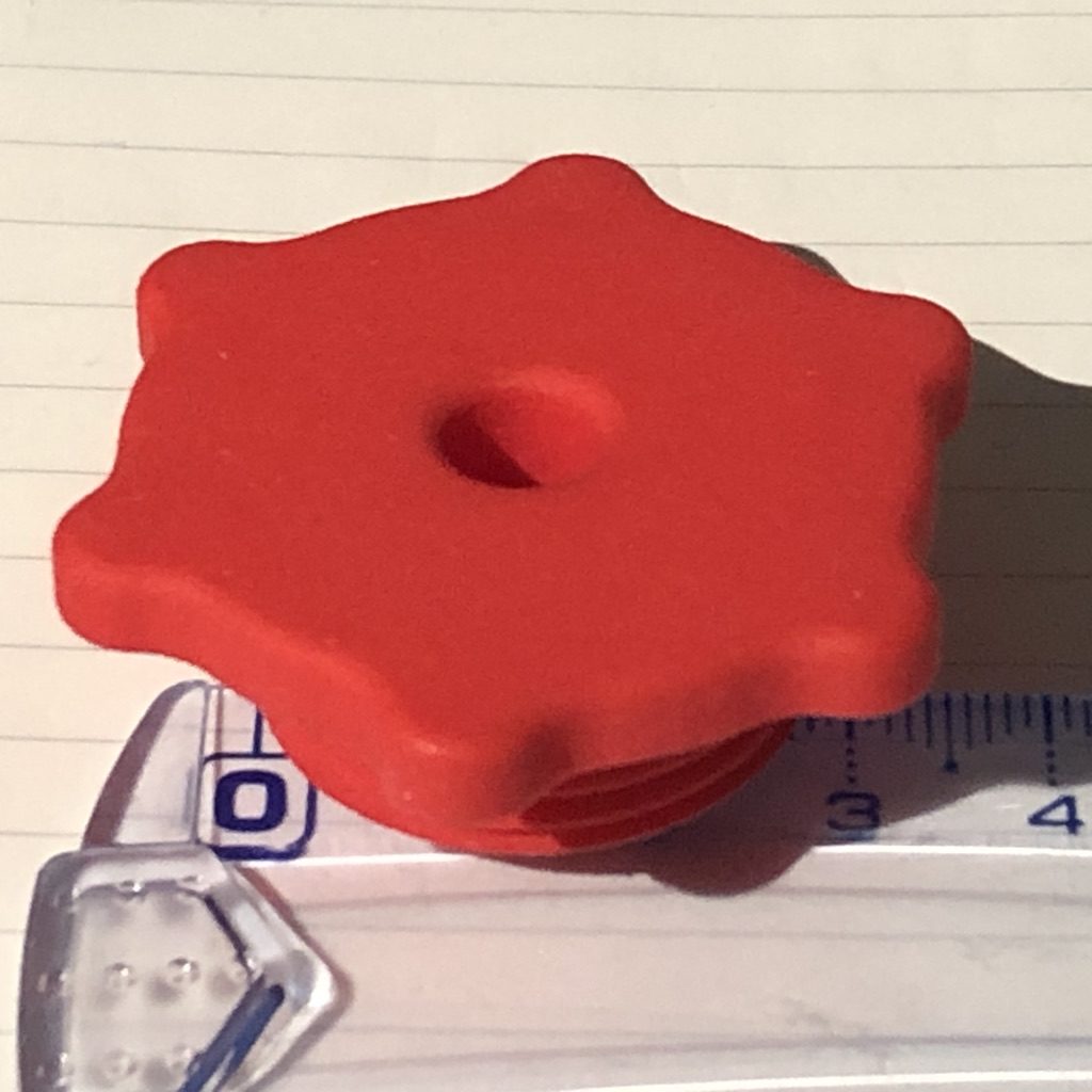

Well so far it looks like the OD of the printed threads is larger than the the stock dipstick.
Printed threads OD: 1.120?
Dipstick threads: 1.091?
My thread gauge only goes to 13 tpi so I can?t verify it?s printed at 12 tpi.
Next I?ll sand down the OD a bit and see if that does the trick.
Wirejock, You should talk to Steve/Amanda Melton about printing you one. I?m a rank beginner. I can?t draw/ fix threads yet (haven?t worked my way to the thread drawing chapter of the beginners solidworks book).

oil filler plug
I got my plug from Shapeways, looks ok. Have not yet tried it or measured it as my airplane and tools are in the hangar.
I just sent an email to Steve Melton (rvplasticparts.com) to see if he would like to add the cap to his product line. I sent him the STL file link.
oil filler 3d printed
This worked perfectly, screwed right on all the way. Here's the dipstick and the plug side by side.

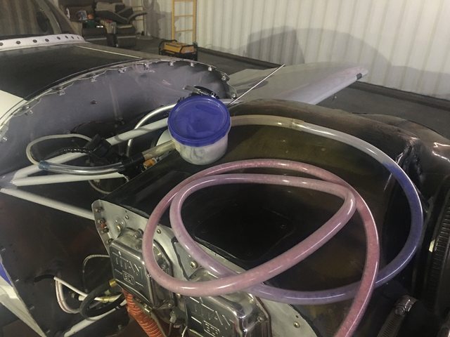

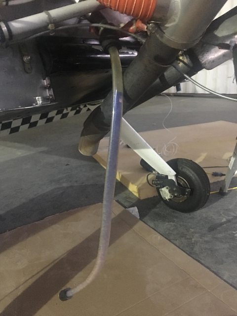

I built 2 of them for my planes late last year. The canisters are Ocean Spray juice containers, and it's a sizeable amount, and it has a pump with 2 outputs.
I also bought vinyl caps for the exhaust (added "remove before flight" ribbons) to seal the exhaust. I bought stoppers and a stopper boring tool. Each plane used different stopper sizes for the dipstick hole and the crankcase vent. I did a closed loop system so I wouldn't have to change desiccant as often. I doubt it matters but I blow air in the dipstick and out the crankcase vent.
