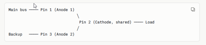

Purely a guess, but it's logical to assume a diode "or" arrangement.
I'm working on the open source ignition system design and this exactly how I have it set up. It's simple and pretty cool.
Here is a summary from the design document (with help from Claude)
The OR-diode is one of those circuits that looks almost too simple for what it does. Here's what's actually happening, built up from first principles.
The basic idea
You have two voltage sources — the aircraft main bus and the backup battery — and you want whichever one is higher to supply the load, automatically, with no relay, no logic, no control signal, no moving parts.
You get this for free from a fundamental diode property: a diode only conducts in one direction, and only when its anode is more positive than its cathode by at least the forward voltage drop (Vf).
Each source has its own diode, both cathodes tied together at the output rail. The source with the higher voltage wins — its diode conducts, the other diode is reverse-biased and blocks. No current flows backward through the losing source.
Walking through the three operating states
State 1 — Normal flight (main bus healthy, ~14.2V; backup at ~13.3V):
  • Main bus anode: 14.2V. After D1's forward drop (~0.3V Schottky): cathode = 13.9V at the output rail.
  • Backup anode: 13.3V. D2's cathode would need to be below 13.3V to conduct. It's sitting at 13.9V. So D2 sees 13.3V on its anode and 13.9V on its cathode — reverse biased, blocks completely.
  • Result: main bus supplies everything. Zero current drawn from the backup battery. It just sits there fully charged, waiting.
State 2 — Main bus fails (drops toward 0V):
  • D1's anode falls. The moment it drops below (backup voltage − Vf), D2's forward voltage condition is met and D2 starts conducting.
  • The transition is not instantaneous but it's very fast — diode switching happens in nanoseconds. There is no relay to energize, no comparator delay, no firmware involved. The physics just works.
  • Result: backup battery takes over the load. The output rail sags slightly (by D2's forward drop) but stays live. The ignition system never sees a dropout.
State 3 — Main bus partially degraded (e.g. 12.5V; backup at 13.3V):
  • Main bus anode: 12.5V. D1 cathode would be ~12.2V.
  • Backup anode: 13.3V. D2 cathode would be ~13.0V.
  • D2's cathode (13.0V) is higher than D1's cathode (12.2V), so D1 is now reverse biased. D2 conducts.
  • The backup has taken over even though the main bus is still partially live — because its voltage is higher after the diode drop. This is actually the correct behavior: a degraded main bus is not something you want to draw from.
Why Schottky specifically
Standard silicon diodes have Vf ≈ 0.6–0.7V. Schottky diodes have Vf ≈ 0.2–0.5V depending on current. Two reasons this matters:
  1. Less voltage lost on the output rail. Your backup battery at 12.8V becomes 12.3–12.5V at the load with a Schottky vs 12.1V with silicon. At the low end of battery discharge this headroom matters for the regulators downstream.
  2. The voltage differential determines the switchover point. With two Schottky diodes of matched Vf, switchover happens when the main bus drops below the backup voltage. With mismatched diodes the math shifts slightly — worth using the same part for both D1 and D2, which is why a dual-common-cathode Schottky package like the MBR20100CT is so clean: both diodes are on the same die, thermally matched, identical Vf, in one TO-220 footprint.
The MBR20100CT specifically
This is a dual Schottky, common-cathode package. Both anodes are separate pins (Pin 1 and Pin 3), both cathodes are tied internally to Pin 2 (and to the metal tab). This is exactly the OR-diode configuration in one part:
The 20A rating is massively oversized for OASIS's actual current draw — which is intentional. At low currents a 20A Schottky runs cool and its Vf is at the low end of its curve, minimizing the voltage drop on the output rail.
The basic idea
Oh, and you can get 10 or em for ~8 bux.

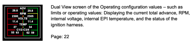

Pmag (correct me if wrong) lets you fly along with no indication of a failure.
To the best of my knowledge, this is correct. I'd need the engine bridge and EI Commander guys to chime in if they have found the ability to see if the internal generator is working or not. The pmag does report "internal voltage" - perhaps this voltage will change if external power is removed or the generator fails. Here's what I understand that can be seen:
There is a note in one of the EI Commander docs I have that says this:
VOLT bus: The internal voltage reported by the ignition. This does not correlate to the aircraft’s voltage.
In this context, I'd offer that the probability of taking the airplane down is on par with any other well maintained EI - unlikely.
That said, when I was flying Pmags I rarely checked the internal generator function, and I suspect that many people still don't. The marketing safety net of the internal generator always being there does shape pilot behavior. But even for those who DO the check at every run up, thats still no guarantee the generator does not fail in flight and the unit switches seamlessly to emergency power without the pilot knowledge. At least one other EI product gives you a warning light that you are off nominal. Pmag (correct me if wrong) lets you fly along with no indication of a failure.
Add a fault indication output to the list of potential Pmag improvements. But if you multiply the probability of a power failure that won’t provide the power a 9V battery will with the probability of an internal generator failure even with just one working Pmag it’s still a pretty safe design.
If someone would develop an add on LED that said "Ign Emer Pwr" to let the pilot know he was off nominal, I think that would be a valuable bit of SA.
The other thing about Pmag failure reports to note is how many there are in operation. A recent VAF aborted poll suggested it might be a big number.
If there was a way to get this on the panel that would be better, I wonder how many people bought a pmag because it's a direct mag replacement, but then also add the controller box and monitor it on their phone. Seems like the type of person that would be drawn to the installation simplicity wouldn't also be the person that adds the monitoring.
