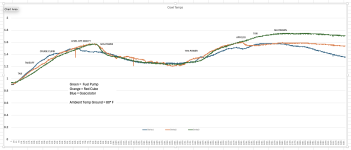

Just as a brief followup, these are the undercowl temps I recorded yesterday using Pete Howell's datalogger. It uses LM34's, so multiply Y-axis temps by 100. They were secured to the fuel pump, red cube, and gascolator. About 55 minutes from startup to shutdown, and after shutdown until it was clear that temps were all decreasing. Not as hot under there as I anticipated.

Mac, before I spent time and money on cowl flaps, I'd revise the fuel system.
The boost pump should be behind the firewall, where it is cool. Elbows should be minimized in the plumbing between the tank selector and the boost pump. Bring the fuel through the firewall with a SS bulkhead fitting, then run a short, insulated teflon hose directly to the engine driven pump. The red cube should be downstream of the engine driven pump. It's a moderate flow restriction. And do you see a fuel flow change when you switch the boost pump to ON?
