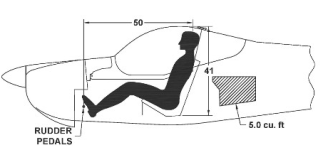

Hey everyone,
First off, this is just a brainstorm. I have no intention of convincing anyone to build this, or to push for a kit — just putting the idea out there for discussion and curiosity.
I've been following the modern wave of tandem-seat, Rotax-powered aircraft like the Shark UL, TL Stream, and Flying Legend Tucano-R. These aircraft offer sleek looks, sporty handling, and reasonable operating costs.
It made me wonder: could a 90% scale RV-8, specifically optimized for a Rotax 912, 915, or even 916, fit into this same market niche?
A downsized RV-8, with about 7.1 m span (vs. 7.9 m) and 6.0 m length (vs. 6.7 m), could potentially offer:
- empty weight around ~378 kg (estimated)
- MTOW around ~655 kg (estimated)
- about 250 km/h cruise with a Rotax 912 (estimated)
- possibly 280–290 km/h with a Rotax 915 (estimated)
- fuel burn around 18–22 L/h depending on engine
- great handling and short-field performance
- still with the classic RV fighter-like tandem seating

What would a standard RV8 need to look like to have the 916is installed? How far forward would the spinner need to be extended? It's within the design power envelope.

It wouldn’t be a bad idea, but I’d go further — I’d consider adding other smaller and thinner wings, like those on the RV-4.

A longer nose would increase the surface area forward of the CG.. may impact yaw stability and spin recovery without a bigger vertical stab or an addition of a dorsal fin.
I’ve owned both the 8&4, the 4 is the best design of all the Vans, anything smaller would be too limiting. Whilst I own both Lyc & Rotax donks I prefer the ‘truck’ type Lyc donk for outright simplicity👍

I tried to sketch an RV-8 with the Rotax 916, based on the RV-4 equipped with the Rotax 915iS built by the German Robert Haag.
And as you can see here, yes, the engine had to be mounted further forward.
I understand your point of view, especially since this was done on the RV-9 with a Rotax engine.
But in the case of the RV-8, I assume that if the RV-4 had no issues recovering from a spin,
the RV-8 certainly wouldn't either, since it has a larger rudder and vertical stabilizer area than the RV-4.
Not to mention that we can work with relocating the batteries and other components to adjust the CG.
