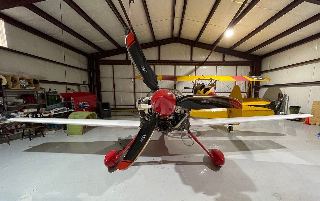

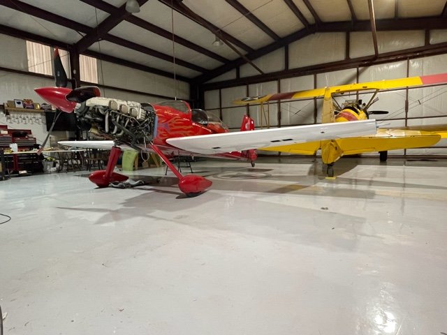

Just a quick update: Bob Mills has started mounting the first set of wings on his Rocket Six, and it is looking good!
Looks sooo close to flight test . . . .:D
Bill, you know the old 90%/90% rule right? ;)
Steve, Bob and I hit it hard over the winter and spring, and Steve was truly an Ironman. He spent hours and hours (weeks, actually) on fill and sand and making the airfoil meet his very exacting standards, all while directing me on a myriad of steps with ailerons, flaps, hinges for both of those, pitot tube, access panels, and fuel system items. We built a paint booth and a shipping crate for my trailer, and Steve did final finish and paint, then crating, while I was at Flight Safety for a few weeks in late April.
Once we got the wings to my place in TX, the first trial fit was exciting, and that is when these photos were taken. Working on front and rear attach brackets, then fuel system (upsized from -6 to -8 on this wing), then root fairings and tips (Steve’s working on prototypes of those glass parts now). So 90/90 may be accurate. I’ll post more photos of those last few build months and the fit work when I’m back home from PRS.
Fun and exciting, and lots of work to go!
