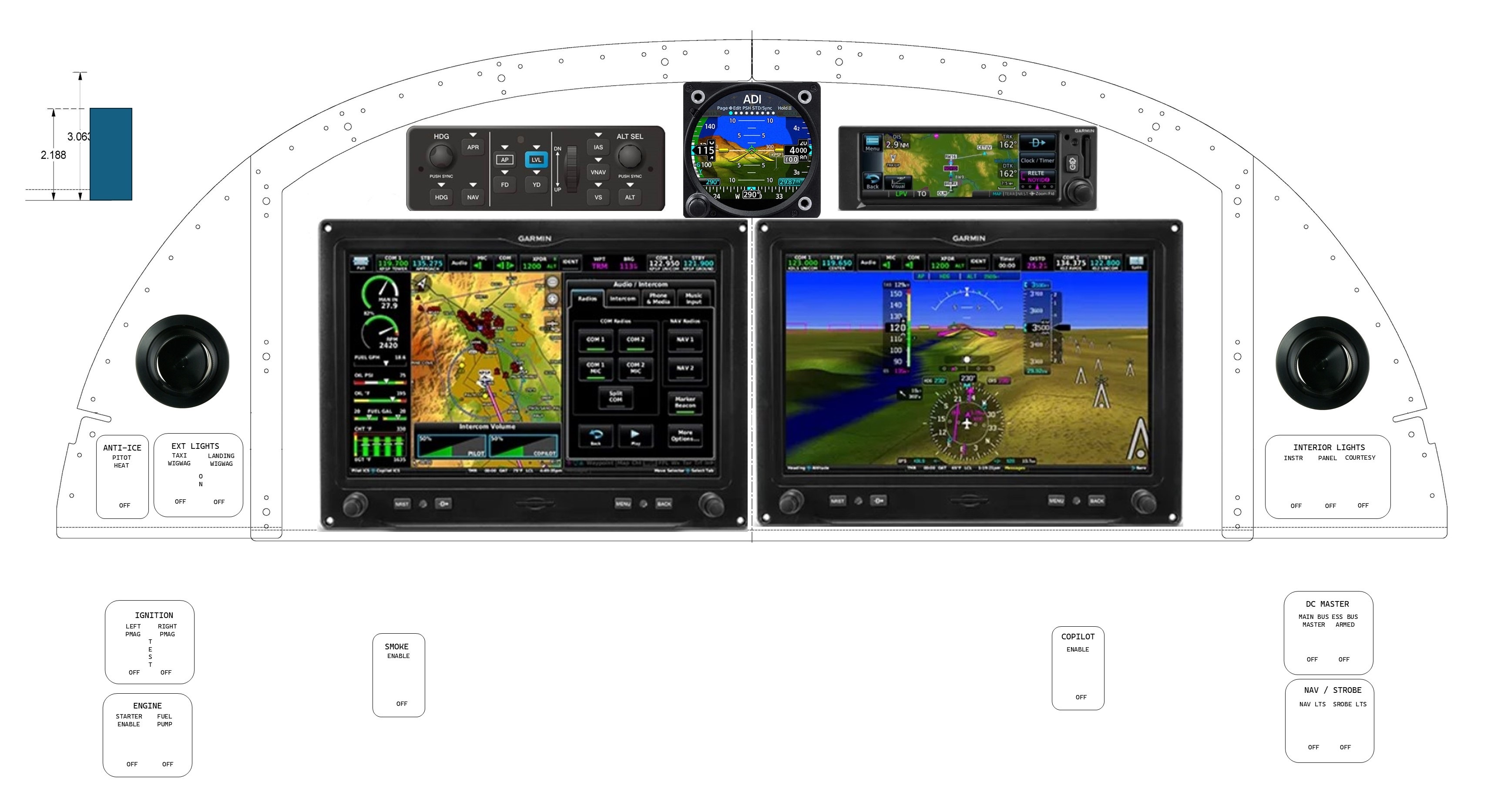

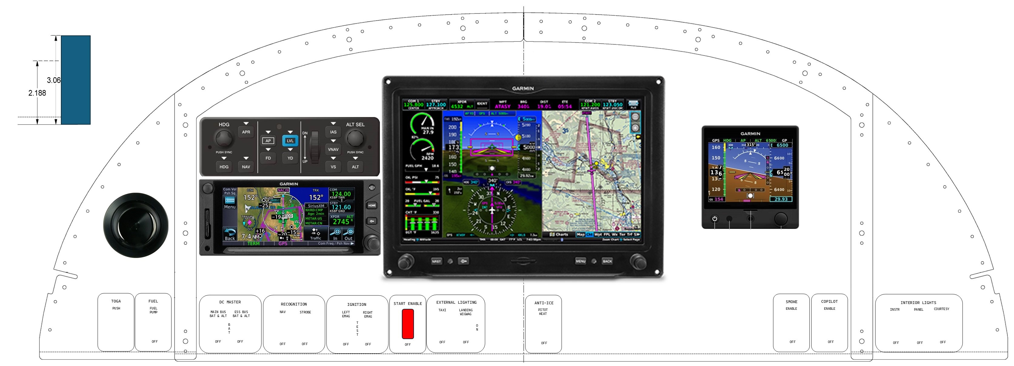

So where do we put these switches? Originally, I was thinking about a dual-giant-display layout. That looked cool, but recently I got to sit in an actual RV-8 while thinking about reachability and ergonomics.
The bottom line is that two big garmin screens is overkill. I should really do just one. Also, I think the switches at the bottom of the center instrument panel is going to be best, and also alleviates a alot of the right-hand left hand shenanigans.
So now I'm back to this single-display scheme, with all the switches along the bottom edge.

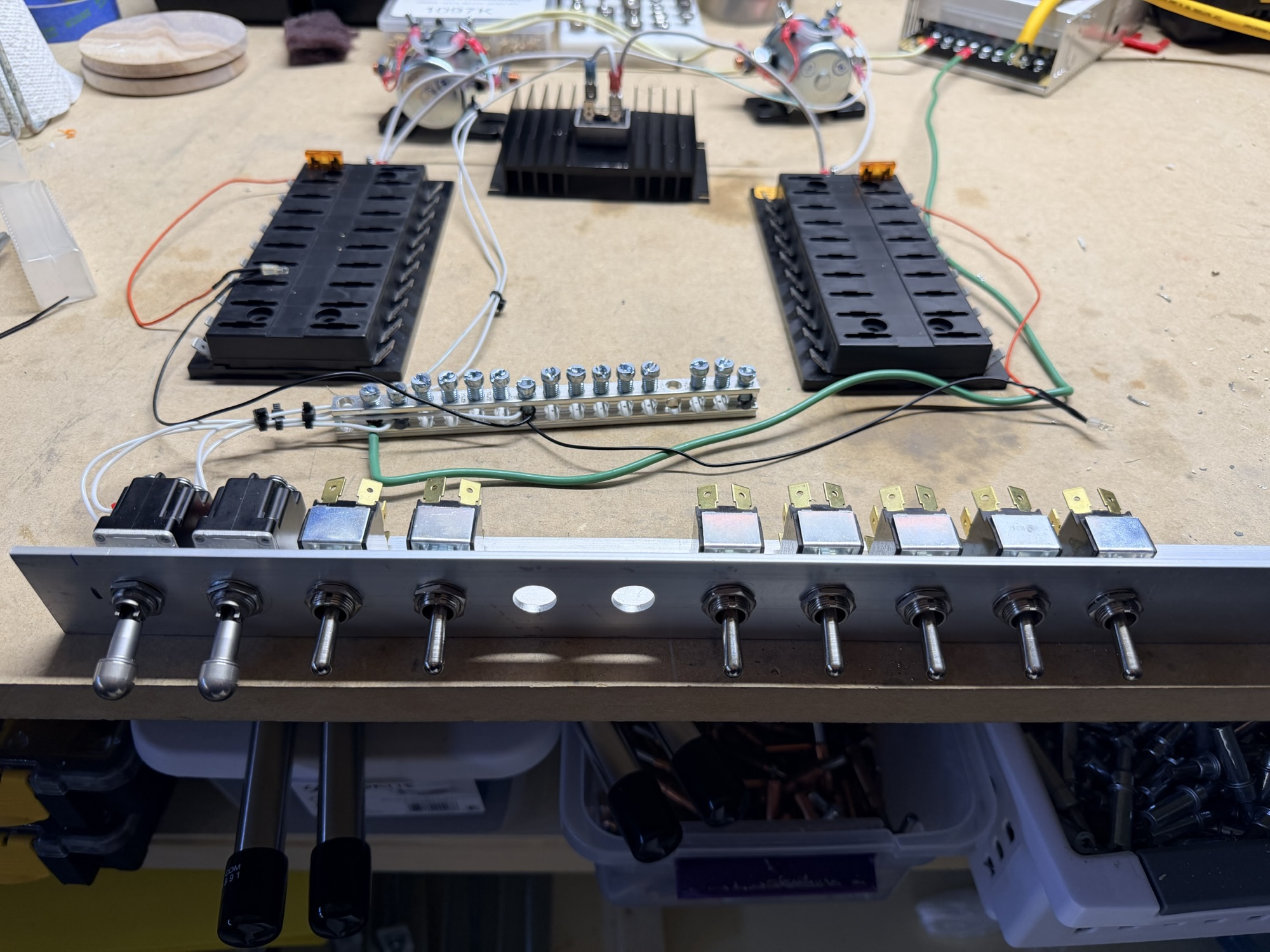

As a continuation of my last post, I decided to buy some parts and start experimenting with actual electrons.

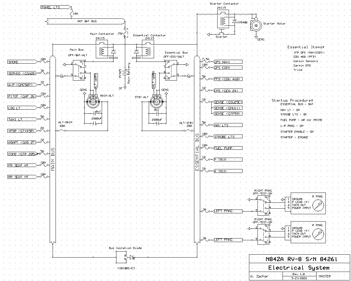

But first, I wanted to draw up my schematic in a way that's presentable.
Here's the latest schematic based on my latest "option 2" split bus architecture concept.
June 03 2026 Schematic
Lots to talk about here, but basically (and quoted from my last post):
I’m thinking about putting all of my essential items PLUS what’s needed for engine start on the E-BUS. I can climb in the airplane, turn on the e-Bus, and have PFD, GPS (NAV1 & COM 1), EMS, Trims, Fuel Pump, Nav Lts, Strobes, Audio Panel, and the Starter (but observe that other items are not powered, which means the diode is working).
I can start the airplane with those, see the aux alt charging the battery, flip on the main bus & Alt, and watch the main alt take over and the rest of the boxes power up. Now flip off the e-Bus contactor and make sure everything stays powered. I’ve now checked both alternators, both contactors, and the diode. No additional electrical checks are required. (Side note, on shutdown, stop the engine, then turn off main bus first, see the e-bus equipment stay powered, then turn off the e-bus.

I'm still waiting on two locking switches for the ignitions
The cool thing is when I flip the EBUS switch, the ebus comes on. When I flip the main bus switch, BOTH busses come on (as designed).
I would like to get these components mounted to a 2'x2' plywood board so it can stay intact and move around the shop. Back to Lowes.

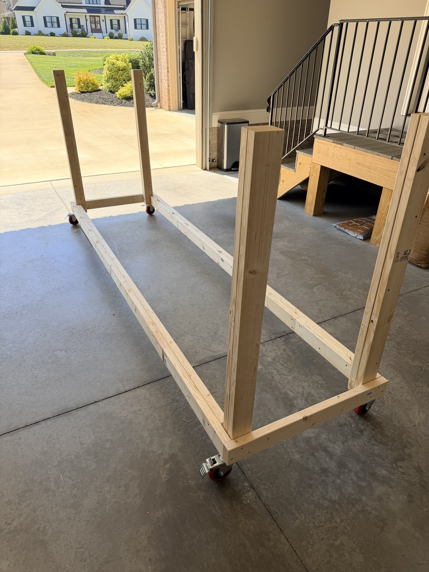

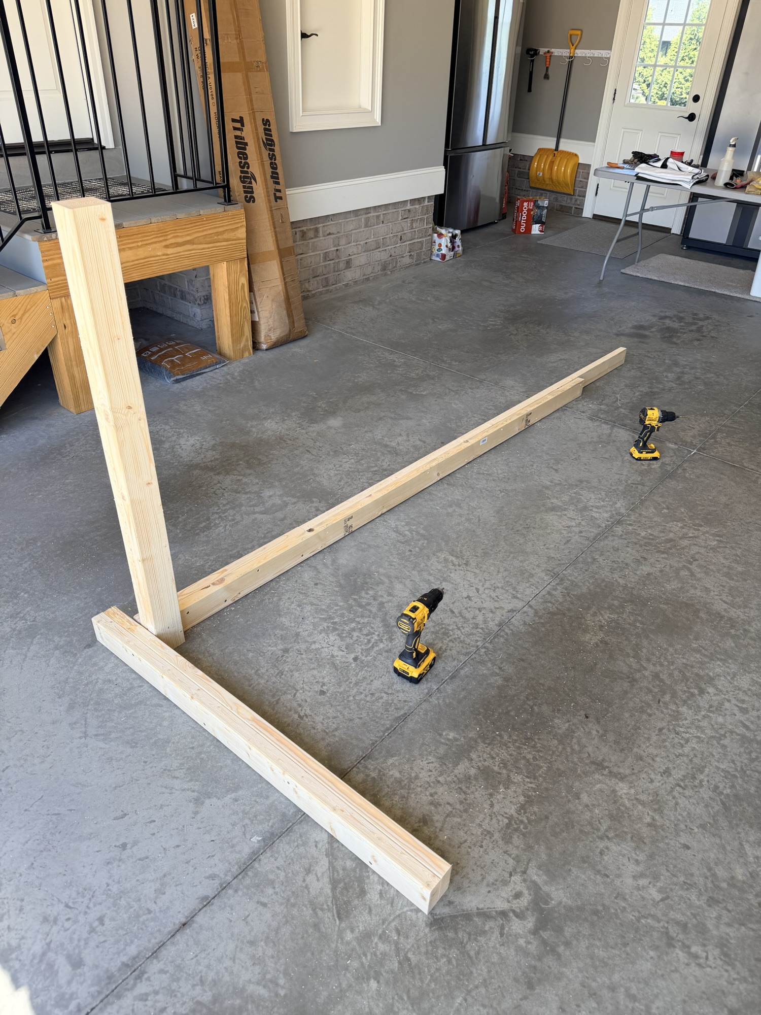

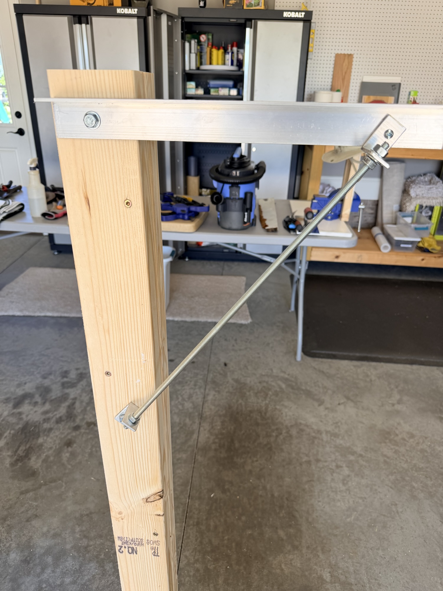

As I mentioned in Wing Stands Part One, I've done this before here and here, so I had the general idea of what I want to do, but I'm thinking about some updates.
Here's a shot of what I had before and my sketchup model of what I'm going for this time:
I think this picture was from December 30th, 2010.
That's the dream (but with smoother wings, of course.)

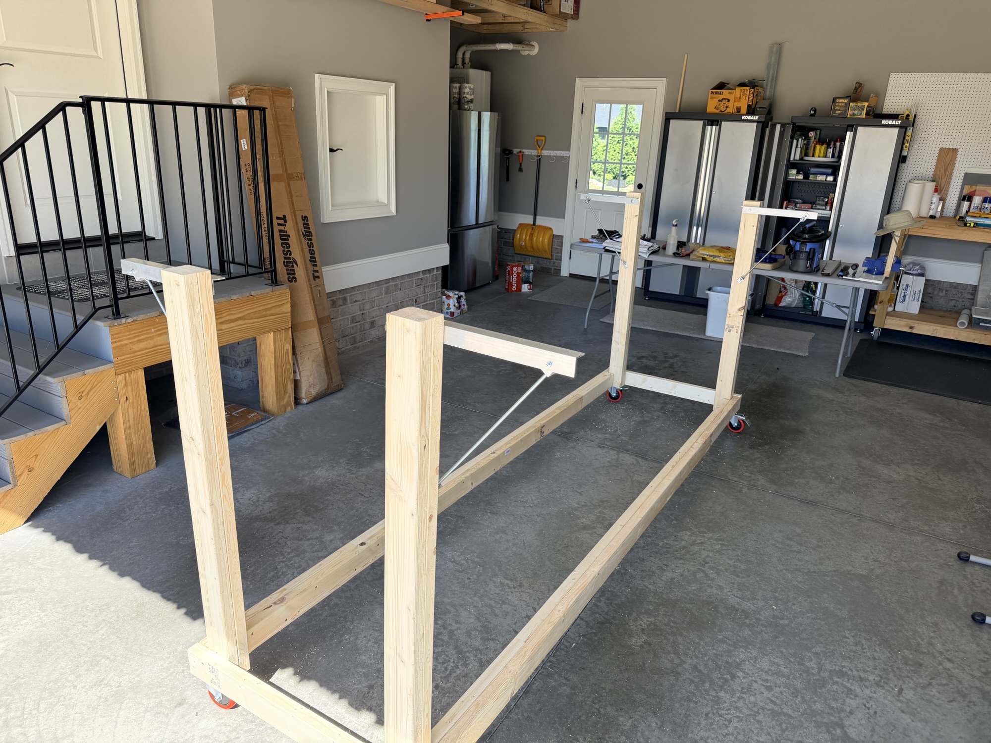

Today, I had $100 burning a hole in my pocket (no I didn't) so I decided to grab some lumber and some locking 4 in. casters from the aviation aisle of my local big box store and whip up some wing stands.
I ended up sticking pretty close to my original plans, except I doubled up the long braces along the bottom.
An in-process pic, before I started sweating too much.
After repeating that first corner three more times, flipping the assembly over, attaching my locking 4-in casters, I flipped it back over.
It's bigger than I remember.
I had previously made the supports, so all I had to do was measure and drill some pilot holes for the 5/16" lag bolts I used.
Here are the support from part one:
Throwback!
A closeup for you, once attached.
a work of art!
And here are all four.
4 adjustable supports attached.
I'm not yet done with the stand. Each of the supports is going to get a small triangular support near its base to stop any north-south and east-west movement. The pre-punched RV-8 wings will provide stability once they are attached, but I'm not happy with the flex in the system yet. a few supports will stiffen that right up. 1.5 hours today.
