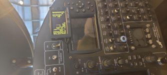

FWIW, the Plex Usdm Pro display is a very powerful little display if you have legacy EFIS with limited inputs and limited panel space.
One great feature is the dampening (filtering). I installed the NTK on one bank and the AEM in the other. The AEM display bounced around a Lot, the NTK less (on the more filtered setting), but still too much (displays mounted behind the panel. (Plastic plane brand “L” with IO550N)
I also wanted to set up LOP and ROP targets to that showed the boundaries of the GAMI Red Box. Percent power based on MAP & RPM (6k msl). Somewhat crude, and still working out the kinks. The Usdm has math channels, but is antiquated 8-bit and lots of constraints. Also, MAP and RPM didn’t work off the LSE plasma given the very low voltage scale. Etc. ugh.
Off topic, I got a bargain on a Gill debris sensor to show on the display (chip detector that measures particle count) but still in testing phase. Kind of cool and could actually be useful.
FYI, Plex is working on an updated Usdm display, “coming soon”. Not enough hours to comment on sensor life but that engine has tuned intake runners so I run LOP shortly after takeoff. AFR makes that so easy.
