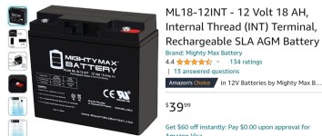

The PC680 weighs 15.4 pounds. MightyMax ML18-12 GEL Battery weighs 12
pounds. I think weight is a better metric to judge a battery's capacity
because some manufactures tend to exaggerate their product's capabilities.
Another one using Mighty Max here.
I actually have one PC-680 and one Mighty Max in parallel in a slightly larger box than standard in my RV-6A. Two years and on problems yet.
Art
