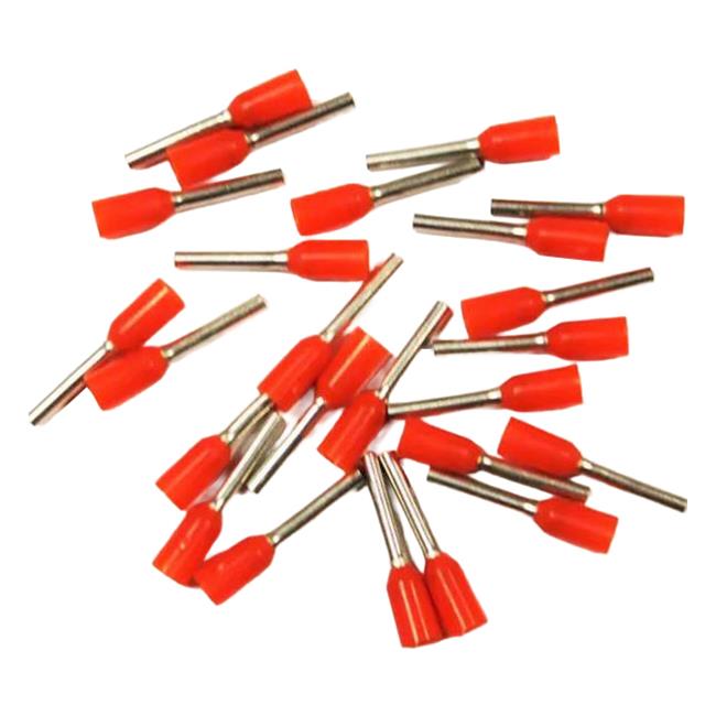

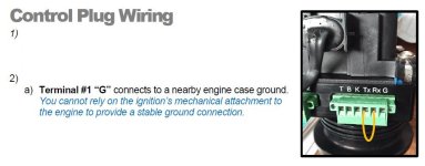

Never a fan of the terminal strip but they work. Do YOU really think your many connections via Crimp on Spades, Crimp Ring Terminal, Molex or D-Sub connectors are superior? OK. Terminal blocks work well especially if you use wire ferrules (not needed but made me happy).
DX Engineering Insulated Wire Ferrules P-Mag electronic ignition terminal strip, the maximum wire gauge is typically 20 to 22 AWG. The terminal blocks only accept pins, stripped wires, or wire ferrules with an outside pin diameter of roughly 1.5 mm to 1.7 mm (0.055-0.065). Next size down is 1.2 - 1.4mm might be better.
See Videos below:
P-Mag has three wires and it does not need any of them! :unsure:😊. The 3 wires, P-Lead (switch to ground to disable), Power (for start only). and short ground jumper. There is an optional tach signal. The optional jumper for A/B timing curve is a short jumper, not a 4 foot wire running from the propeller through the baffling and firewall. PMAG will continue to RUN if your wires fall off. IT STILL RUNS LIKE A MAGNETO!!!! THIS IS WHY IT HAS AN ADVANTAGE... Good old reliable farm tractor technology. Wiring is less important to the P-Mag, as it is self contained and self powered.
BTW Pin 2 and 3 for the A/B timing curve jumper is also RS-232 port as some may not know. If you want to track your timing advance and other factors... in flight you can. EI Commander is a stand alone panel mount monitor for the P-Mag.

How Ferrules work
Yes, and again, Amphenol AT connectors, specifically engineered for engine compartments.
Crimped terminals are unsatisfactory, but you recommend crimped ferrules? You say they're not needed, but offer a video demonstrating why they are?
