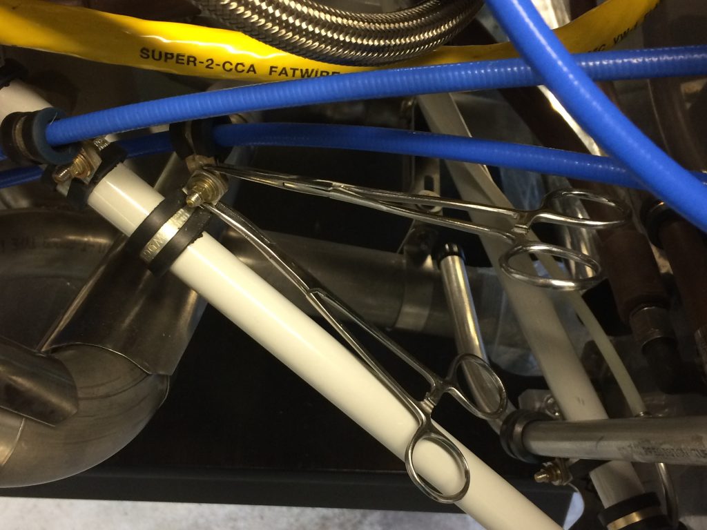

Hemostats for the win
Just can't say enough about how much easier these things make working with the adel/cushion clamps.
I squeeze the clamps shut with what ever tool it takes, with a bolt in the hole. Then take a bit of safety wire and wire the clamp shut, remove bolt and you are ready to go. I often will tuck the tail of the safety wire out of the way and leave it on the clamp. This makes future adjustments or maintenance a lot easier.
4" tie wraps work well, particularly in tight spaces and with more than one adel stacked up. Depending on the situation, I'll simply leave the tie wrap on, pushing it out from underneath the bolt/washer/nut. Makes for dis-assembling the stack easier next time.

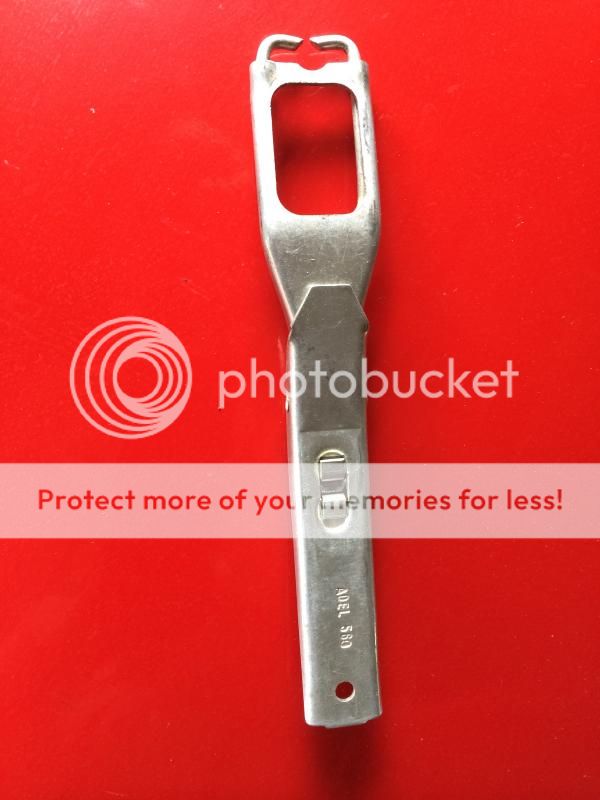

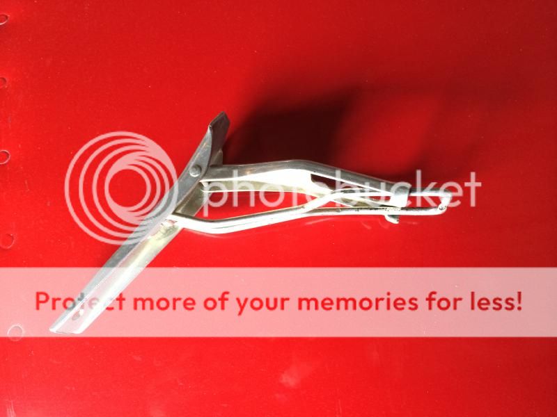

What an elegant design!! I hope the 561 is the same width as the 560, I ordered one, will report. I dreamed an configuration like this but (without the split end) just clamped and used safety wire to hold them. Now all is done the right tool will be available for service!
10yrs of VAF & OSH & SnF . . . and NOW it gets posted! Edit -I see Gary posted the same back in 2014 - I guess I was working that day.
Thanks for sharing Gary! Bloody fingers will thank you. Ron Schreck said it best.
OK, make that another one sold - not sure how it works though - Condor, you need to post a video/pictures!
15 sold now - I bet that guy is wondering what the heck happened today, and where he should be advertising. DR - you listening?

Spruce sells Adel clamp tools, p/n 12-02017.
So does Wicks, p/n ACP.
So does Skygeek, p/n ATS-SMA-101.
I'm sure others do, too.
