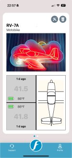

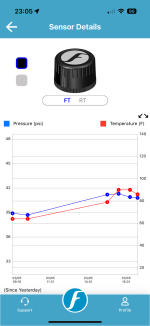

I'll chime in here, even though this a -12 subforum and I have -7A. After my buddy put the FOBO sensors on his -14, I followed suit a few months back, and so far couldn't be more pleased. On the 7, no issue with clearance on the mains but they won't fit on the nose (the stem is too close to the rim). The app works great, within a minute of opening it on the phone, and even in flight. AND, nobody mentioned that you can send the datalog from the app to an email address as a CSV file, so you can plot the change in pressure and temp over time!
Can't talk to battery life yet, but so far so good...and saves me the ever-present self-questioning about "hmmmm...does that tire look like it's low, or not?" before every flight :).
ETA: See pics attached. Note that there's non option to select an airplane type, so it thinks it's a Motobike :), and for the plots, FT = leFT and RT = RighT (it thinks it's Front Tire and Rear Tire lol!). But aside from those nit-picky details...
