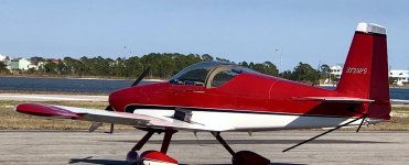

Ok, so... went to sun n fun and was fortunate enough to win a Delta Zulu in a giveaway. Yeah! I took the Aithre monitor I had literally just picked up from Spruce back for a refund. Imagine my surprise when the CO alert alarm goes off an hour and a half into my flight home. Over 50ppm. Well, what do you do? Seriously, clear day, no heat on, cabin vents open - what is different? Turn the cabin heat on - any change - did it go up? Nope, same. Figure if it was a leak into the cuff and I OPEN the heat duct, I should see an increase. So where is it coming from? Then like five minutes later it drops down, and finally just goes away. Then about a half hour later it pops back up again. Five or ten minutes and it drops away again. Scratching my head. I've had the plane up twice since and seen nothing, then today on the way home from a quick 30 minute flight it jumps all the way to 90! At 5500 and I had a quartering tailwind at the time and have to figure that the quartering wind is sending exhaust back into my fuselage somehow. Pulse ox showed 93. Climbed to 7500 which but the wind directly off the tail and the reading dropped to 3, pulse ox back up to 95. I know pulseox doesn't read CO, but still thought it was interesting data in the moment.
What troubleshooting, seals, mods, parts, adjustments, etc... let me get after this and figure out what is wrong?

Two things to look at. 1) you are probably running too rich, which causes less efficient burning of fuel, and thus more CO. If you lean more, then you will generate less CO. 2) exhaust fumes are getting into the cockpit, somehow. Many people have reported that exhaust fumes can get in from the tail of the aircraft or the flap pushrods, and that opening air vents increases the pressure in the cockpit, reducing the influx of exhaust from the tail. From what you described that opening the vents didn't change anything, I would recommend checking for cracks in the exhaust system (something that should be done yearly anyway).

Saw this is another RV-12. Run a piece of aluminum tape along the cowling/fuselage seams - vertical sections and the small horizontal section which is in line with the air vents. Fly again and report back.
I have a friend here with an RV 14. He had exactly the same issue. Only with very high AOA's he'd get warnings. I suggested he close up the little holes on the tail aft of the fuse. That small flat area back there. He did with some RTV. Problem solved.
Panzer, Sorry, I don't have any pictures. I'm talking about the area all the way aft on the fuselage.... the end of it. It's just forward of the rudder. The fuse area where the bottom rudder hinge bracket is mounted and your taillight wire comes out. That area there. My RV 14 friend sealed those up and the CO alarms stopped.
Ok, found a picture. Click on the photo and see the arrow. I'm talking about the aft end of the fuse between the fuse and forward of the rudder. Hope this helps.

So, determined the following today. The exhaust system leaks, but not inside the heat cuff. We put pressure into the exhaust and got significant leakage at every join - downstream from the ball joints, as well as at the straight join just below the headers, on both sides. The exhaust system is a Vetterman.
Leakage at top (right) of pipe clamp, just prior to ball joint. Ball joint does not leak itself.
Leakage at join on crossover pipe, right side of hose clamp visible on left side of photo. Also leaks at top of pipe clamp in center of photo. What looks like a crack in the middle of the top of the 'Y' on both the top pipe clamp and the pipe itself, is just a bad angle on the photo. No crack actually there.
Is some degree of leakage into the cowled area forward of the firewall just assumed to occur? A 'normal' condition? If I assume that the answer is yes, I am back to modifying the cabin's overall in/out flow profile. Firewall looked good - no obvious leaks. Also no easy way to put pressure on it to find any.
Pulled the tail access panels and will get in there with some RTV soon. Looking in/around the tailwheel spring mount pass through, primarily. Any/all holes on the bottom. Any other areas to look at let me know. I think I can also potentially seal a bit around the rudder cable pass-through conduits.
Will also install aileron push rod seals when they arrive, as well as working to seal off the upstream seams in the cowling to fuselage join (piano hinge and Skybolts) to prevent engine compartment gases seeping into NACAs, per recommendation. No easy way to do this inside the cowling, so may test fly a couple times before I resort to an external tape test, if a problem remains after the above efforts.
Lastly, I may also install weather strip along the back of the aft canopy skirt to see if that limits inflow. If none of this works, will advise and ask for more input. Only thing I can think of at that point is to throw out the Vetterman and buy an new exhaust. Consulted my builder and he indicated he was never pleased with the 1.5" exhaust system - thinks he got sold on a system that promised more than it delivered and wished he had gone with 1.75" pipes. Also, the crossovers seem more complex than necessary - why not just straight out? Recommends on folks to talk to about the exhaust system? I figured I would call Powerflow and let them try to sell me, just to learn at least.

Lots of RVs flying happily with no CO leaks with the Vetterman exhaust. Some leakage at those exhaust system joints will be normal, but eventually they will leak less as exhaust deposits "seal" them. This CO will flow out the bottom of the cowl and be mixed with the actual exhaust which has a lot of CO. Not sure if you mentioned it, but are all your firewall penetrations sealed? That's very important for both CO and fire protection.
If the FW is totally sealed, then you are looking at something finding a way back into the cabin via one of the openings between the FW and the tail, as others have mentioned. Sounds like getting another RV expert pair of eyes on your aircraft would be a good idea.

Just completed my first oil change, with some help, and did as much CO troubleshooting as I could. Talked to Clint at Vetterman and got some good intel from him as well. He confirmed that the joints are not air tight, and in fact, cannot be as the exhaust system needs the flex relief to survive engine vibration. A fully welded set of pipes would crack or shatter. Bottom line - some CO will absolutely be in the engine compartment forward of the firewall.
- Installed Flightline Interiors aileron push rod boots. Wanted to mitigate some of the airflow anyway, and they were inexpensive at $53 and easy to install. Abby was very nice and had plenty of info to help.
- Had an RTV party in my tail, trying to seal up obvious gaps on the bottom. Tail wheel spring outlet, the tail wheel spring through-bolt head, etc...
- RTV a few select spots where (a very, very little) light filtered through my firewall. Basically one nut plate and some micro thin gaps along the join with the fuselage skin.
- Bought another CO monitor from Amazon (could buy six of the one I got for one of the Aithre ones) so I can validate / compare samplings.
- Plane actually had some no-kidding duct tape on the bottom, covering about two feet of the weather strip between the wingroot and the fuselage. I pulled the duct tape off, and redid it with.... Gorilla tape. Still cheap looking, but its on the bottom and I wanted to see if it helped mitigate the problem.
Took the plane today to a nearby airport for pitot-static / transponder IFR cert. Forgot to fire up the second CO monitor enroute, but my DZ headset said the CO peaked at 7ppm. More than I'd like, but way better than 90. On the way home, both the DZ and the Amazon version read zero. Not sure whether this is just condition of flight. I was at 2500, full rich and the flight was only about 20 minutes if that each way. But its still an improvement.
Next steps - I intend to keep monitoring, and keep sealing. Clint at Vetterman suggested that more air comes in from the flap rod holes than through the wings, so they are next. He suggested using a couple pieces of engine baffle, slit for the rod to travel and then RTV'ed to the inside of the fuselage skin. If i do that, I'll post pix. Clint also offered up a couple of exhaust downturners, which he guarantees will fix the problem (assuming it isn't coming in the firewall) but at the potential cost of a fraction of performance. Last thing I may try is to find some decent clear or neutral colored weather strip that would work on the bottom inside side edges of my sliding canopy.
