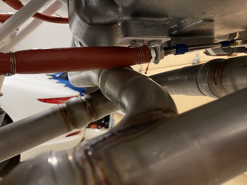

Looks like I get to move my throttle cable mount over... installed per Van's with stock exhaust on I(O)360-M1B...
Untitled by Dave Hock, on Flickr
This is too close and can't really even get the heat shield in place. I will attempt to flip the bracket over as others have done.
Something else to keep an eye on Dave is the two exhaust pipes where they cross underneath. Both mine and another -7 had made contact with one another and actually rubbed an oval shaped area. One of them rubbed all the way through and actually had a pin sized hole. Sent back to vetterman who took care of it.

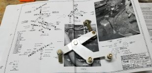

Dave-
I had a similar problem and made a new bracket o replace the one Vans sent. The new one elevated the came up closer to the sump. You can see in your pictures there is some space available above the cable now. I used that to give me more room off the exhaust.
I made the new bracket first as a template out of 032 aluminum in order to get my dimensions right (took 2-3 trys), then ordered some 4130 (I believe I used .062) and mad it from that.

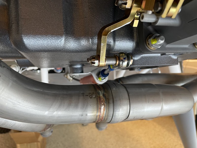

Yup - same problem on my IO-360-A1B6; I also didn't like the angle/routing of the cable.
I did the same thing as prior poster -- make a new bracket out of 18ga 4130 plate. Move the cable hole over closer to the screw bosses and closer to the sump.

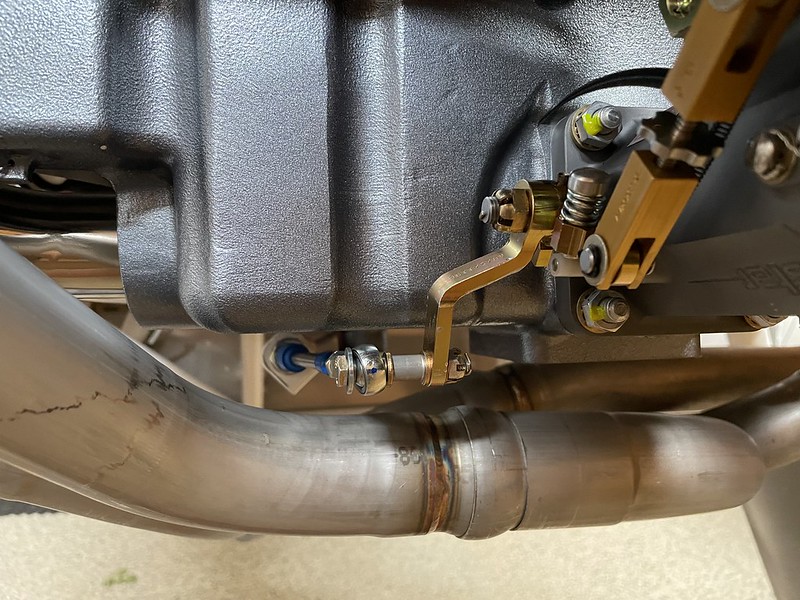

Simple fix, I just flipped the standard Van's bracket over to other side (with a little bending to clear the pan) and put the bolt and spacers on on the throttle arm on the other side also:
Tons of clearance now to the hot exhaust pipes!

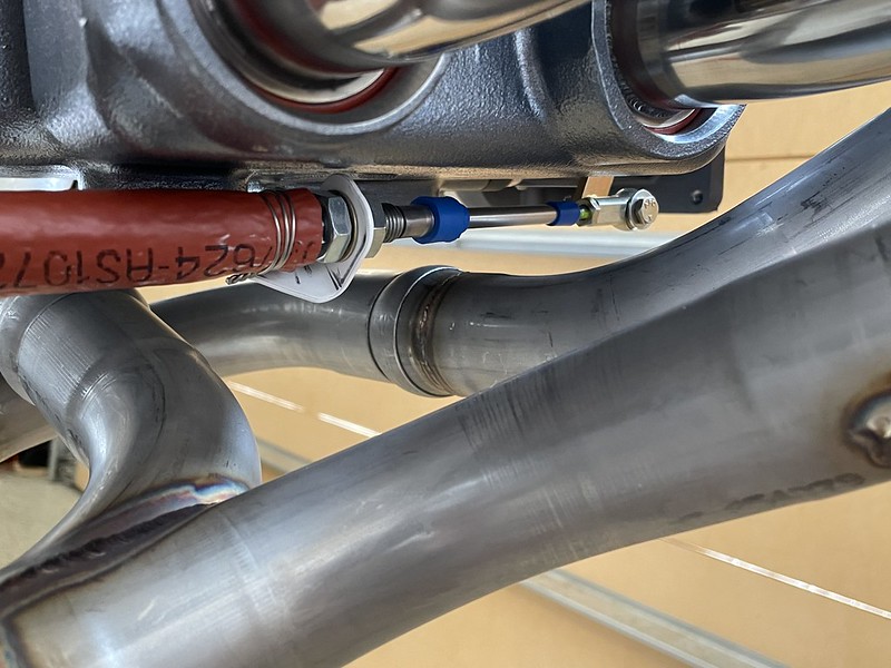

Here's how I shielded my throttle cable from exhaust. Works OK through 90-hours. I have a Superior cold air sump. so I had to fabricate an additional plate to use the Superior boss with the Van's bracket.
If I remember correctly, I did have to warp or flare out the sides of the shields a little bit due to exhaust pipe bends.
