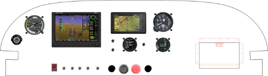

Panel ideas
It will be a while before I get to the stage of installing the panel and instruments, but I used my recent "down time" to do some thinking and planning.
At the time of deciding on the RV kit in 1992 there were no glass panels or even experimental versions of flight and engine instruments. The options were either new (expensive) certified gauges, or second-hand equipment. Most builders seemed to scrounge around and find a mix of second hand gear, and that's what I originally thought I would be doing.
My plane is following the original Vans philosophy of keeping it light and simple for day VFR flying. But I will likely install an autopilot for added safety and convenience.
I learned to fly with round gauges and also like the classic look and so was considering how to achieve this with some modern digital instruments. One of the panel design ideas is based around independent steam gauges, Garmin G5 (or similar) and separate engine monitor instruments.

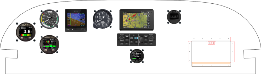

The other design idea is based around an EFIS and is something that I never thought I would consider! However I've been forced to make the transition while flying the Foxbat, which is fitted with only a Dynon D180 EFIS/EMS, single radio and portable GPS. This setup provides pretty well every thing I need but I would like at least backup for ASI in the RV.

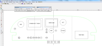

The mockups of the panel layout were done in HangarZulu.com and the more accurate scale drawings using TurboCAD.
I've also been studying the "Aerolectric Connection" for the electrical system, which will be based on the Z11 schematic.

Good thinking on that panel Paul.
Thing is glass has, unless one wants to fill all available square mm of the panel, become very affordable.
I modified my own ship from round strictly VFR gages to dual G5 with their respective battery backup, a GNX375, left the old but still working good VM1000 in, and love that set up. An AP could quite easily be added, but I don’t have the need for one.
One thing to consider are the 2 bulkheads which demand modification if installing larger screens.
In any case, good continuation and good health.

Hey Paul, I too like the look of round instruments. I like your first panel rendition. Good to keep airspeed and altimeter closer together. 1) I think it has been established that with modern efis and magnetometer, you don't need a wet compass, so maybe in WA, you're allowed to delete. 2) Did you relocate your transponder elsewhere from the panel?

Hi Jose, for instrumentation requirements in Australia, we're still required to have a direct reading compass in addition to the EFIS magnetometer. I haven't planned on installing a transponder initially because I live and fly in a rural area where there is no radar coverage. But if required I could add either a remote transponder with the Dynon, or a round head unit e.g. Trig with the round gauge panel. Same goes for ADS-B.
Per Australian regulations for private flying (flight and nav instruments):
Day VFR equipment CAR 174A, CAO 20.18 Appendix 1
The flight and navigational instruments required for flights under visual flight rules are:
an airspeed indicating system, and
an altimeter, with a readily adjustable pressure datum setting scale graduated in millibars, and
one of the following
a direct reading magnetic compass, or
a remote indicating compass and a standby direct reading magnetic compass, and
an accurate timepiece (clock or watch) indicating the time in hours, minutes and seconds (may be carried by pilot or crew).
The panel design will probably evolve a bit more while building the rest of the plane but I want to try and keep it simple! Thanks, Paul.
