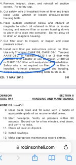

How do you guys safety wire the S15 filter?
Or you don't?
IMG_4289.jpegIf Robinson helicopter doesn’t require saftey wire on a shaking, vibrating helicopter, I think I’ll be ok.. I’ve never seen a filter come loose.. they are always tighter than when they were put on..
View attachment 60442If Robinson helicopter doesn’t require saftey wire on a shaking, vibrating helicopter, I think I’ll be ok.. I’ve never seen a filter come loose.. they are always tighter than when they were put on..
Lots of other places where I wouldn’t mind seeing saftey wire, but aren’t.. Oil hoses, fuel lines.. ect.. but the oil filter? Naaa not needed
Neither have I, the more so the standard filter square seal combination.
Still, the standard filters have the tabs for the safety wire, why not use it? And yes, I drilled and safety wire my S15 everytime.
I bet there are many parts on an engine, or an RV as a matter of fact, which are safety wired, and which none of us has ever seen come loose...
