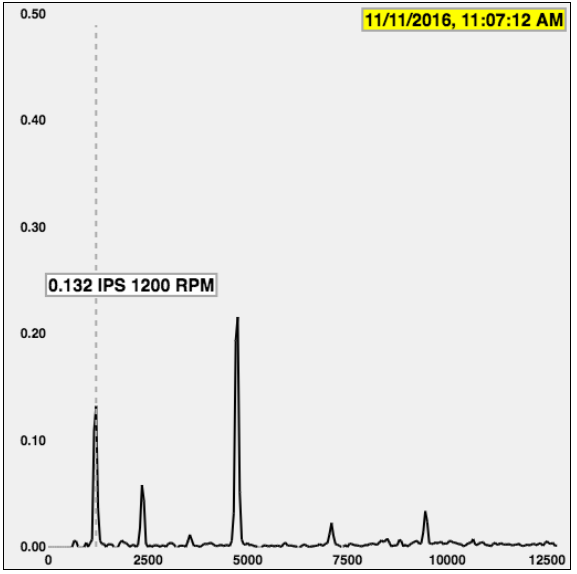

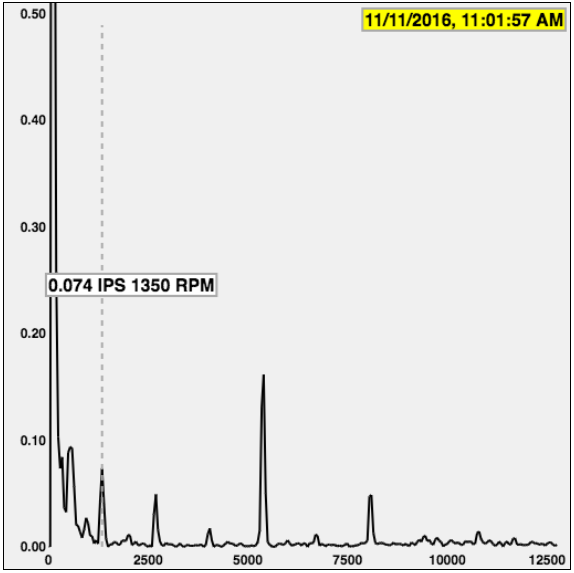

Reclocking a prop 180 degrees
Recently I re-installed (Same clocking as before) my WW prop (Lost a shim and WW Ohio employee resealed it) and after firing it up felt the same as when it was new. Three blade composite props in my opinion almost always "feel" better than metal 2 blade so felt back to at least original install. Checked tracking and within spec but only by 3/64th of an inch. (Limit 16/64ths). Decided to remove and re-clock it 180 degrees (And while it was off install a new alternator belt) I didn't tap out a lug, gather a new tool just rotated it 180 degrees as I had the option of doing originally. I figured it would get worse, better or stay the same and give the Dynavibe an easier task. If it was worse, I would remove and reinstall back to original but figured I has a 2/3rds chance I would not need to remove and reinstall. Tracking after reclock improved 5/64ths and ground runup did indeed feel better. Test flight also "felt" better, so I was able to leave it on and now in a few weeks will get it rebalanced. I've only helped in a few other prop installs but have always had the option of installing a prop 2 ways, (180 degrees apart) and each one would be ok. Not sure what is the issue with special tools and parts needed but again my experience is limited. Seems an easy way to ensure that a prop is at least in the "better" orientation. (Remove and rotate 180 degrees)
BTW theirs an app called Vibrometer if you want to get a ball park number in cruise. Not quite the accuracy of DynaVibe but better than resting your hand on the dash.
Update, rebalanced the prop today (with the prop reclocked 180 degrees) and it took slightly over half the weight that was used before to rebalance.

My prop was dynamically balanced but even that did not help to solve the issue.
After reading this and few other threads I decided to try to rotate my prop 60 deg CW. I removed my prop, sent it to local shop for visual inspection and reseal (since prop is off the airplane why not to get it inspected just in case).
Prop was returned back to me and reinstalled in 60 degrees CW position comparing to original one. I completed two test flights and was impressed how smooth it is now in the cabin.
Keep in mind that I have not done dynamic balancing yet, still waiting for the guy to become available to help me. Even without balancing all strong vibrations are now gone.
I used to hold my arm on the center vertical bar in my RV and was feeling the vibration a lot. Now it is no more than just a little tiny vibrations which is nothing comparing to what that was before.
It looks like this method works ! I will get prop balanced and hope to get even better results.
Thank you to all who contributed and shared this valuable solution here at VAF.
