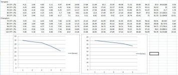

Here's hard data, in two formats, (a) comparison at 10, 30, and 60 minutes into the test, and (b), each filter at 10, 30, and 60.
Yes, there are differences in performance. However, before running out to grab a Wix 51515, note there are other very important factors in a filter decision, like bypass valve opening pressure and enclosure burst pressure. This chart only looks at filtration.

Any chance that the efficiency drops near the end of the test are due to the bypass valves starting to ”weep”some unfiltered oil?
Trends are similar for Tempest and Champion, which have higher bypass opening pressure. Looks like typical filter behavior.
