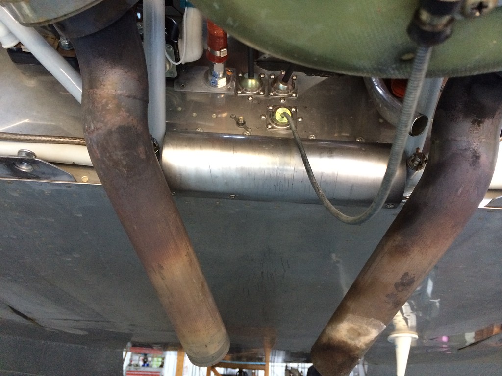

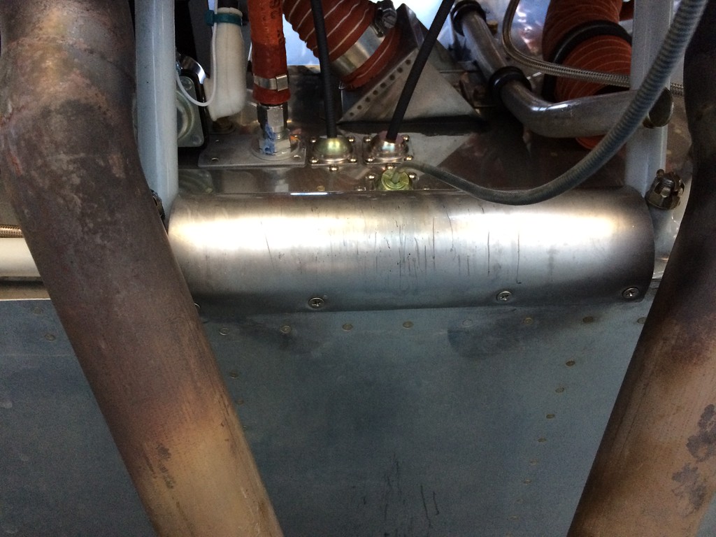

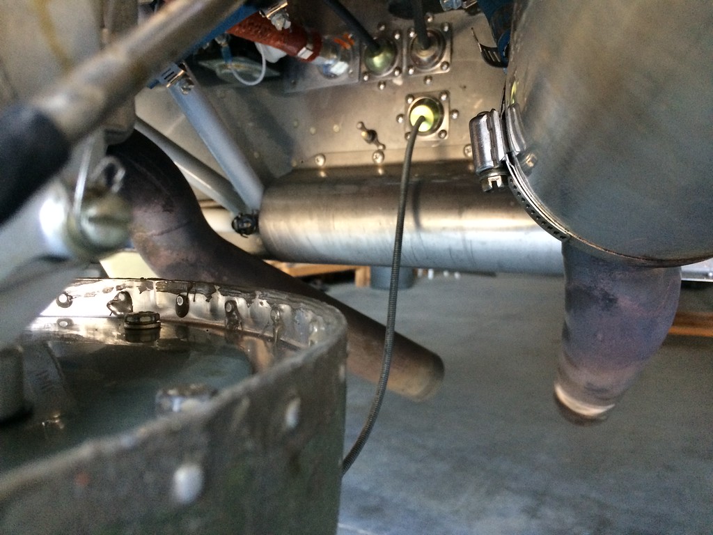

Thought I would have a go at this before the engine gets in the way.
Congratulations or Criticism- both are welcome :)

For the -A models
One idea for the A models that are side-by-side with a flat belly would be to completely remove the 'coal shovel' outlet on the cowl and create two new outlets on either side of the nose gear. The inboard end of the opening would be determined by where the exhaust pipes need to go through, and then extend from there outboard for, oh, lets say 6 or 7 inches. Do this on either side, with the semi-circular lip added, and decide how deep the opening should be, something like 2" or so.
An additional benefit of this would be to get the main internal flows heading for the exits to be outboard of the tangle of pipes that support the nose gear, so there would be less internal loss.
Thanks Steve, I know you've devoted quite a bit of time to this concept and it was reading through old posts by you and others that helped me decide what the vision should be.
Couple of questions if you don't mind;
The upper lip of this is about 1/4" from the firewall. once I get the final configuration, is there any benefit to sealing that with a bead of RTV?
This is trapezoid shaped. The upper section is 9" wide to fit between the vertical firewall tubes. Below the adel clamps it flares out to about 12" at the firewall flange. It was supposed to be 13" which is the width of the coal shovel opening, But by the time I got it trimmed and all symmetrical it had shrunk a bit. How much spill do you think I'll get off the ends? Is it enough to make it worthwhile to build another one a little fatter on either top or bottom sections?
I wouldn't bother sealing the upper lip. The flow will attach itself to the bump somewhere out away from the firewall and flow smoothly.

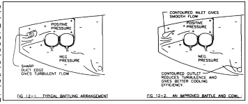

CSOBeech has an article on this as a mod to improve cooling. I remember from reading it years ago. https://www.csobeech.com/Bo-Flow.html
Here are some pics from that article. You can see a small rolled edge that was added to round the sharp corner.

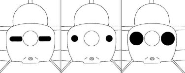

Cowl louvers.
Those of us with the new 7a nose gear with cowl louvers, does this really matter anymore.
I asume the louvers result in a less draggy flow since the area is larger as the flows merge.
But what can us Louvers guys and gals do to improve our hot air flow, besides talking less?

I replaced the large, round cross brace with a more aerodynamic shape. No flight test data yet, but I don't expect much difference.
Edit: The large holes are to fit a home brew rubber bushing.

The system I'd like to see on a 7A would be much like the latest RV-14 cowl, dual fixed exits outboard, a center hinged variable exit inboard.
I'll have something together hopefully by January for the -7. If it works as expected/desired, I'll convince one of the other -7A drivers around town to do a similar modification.
I was going to borrow heavily from the RV-14 EXP119 cowl (the -390-EXP119 with 4->2 crossover) for this project. I probably will take a mold from one to make the exhaust shrouds/lower cowl affair.
I don't plan on changing the inlets, stock-lopsided "D's" from Van's.
Steve - gotcha; my "gross" outlet (stock Van's cowl) is 56sqin, less 12.566 for the 2 stacks -=> 43.44sqin "net"..

I'm one of the nose wheel guys who has a giant piece of steel in the middle of the exit airflow. I'm not sure how much it'll help, but figured if it does any, it's worth the time. I'm wondering if those who are way more knowledgeable would weigh in on this placement. Obviously, a paper template is hard to get to curve nicely, but if it was something like this without the crease, would that work well enough?
I haven't seen anyone with the nose wheel update on any further developments on this.

Allen, that shape looks pretty darn good considering what you have to work around in there. Please keep us posted how it works out. You are on the right track there.
