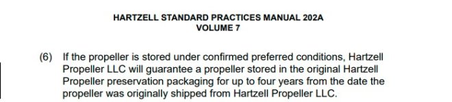

Did find that Hartzell gives a 4-year window for props stored in preferred ambient conditions which seem like most props stored inside would meet.

We don't, to my knowledge, specifically call out a requirement for storage orientation; that being said, the packing for shipping assumes an orientation and is arranged accordingly so use good judgement. Rotating the storage orientation is only working with gravity, which won't do enough to keep the grease mixed, and does nothing for the more immediate issue of the hub side seal no longer being pliable enough to conform to the blade side seal; I don't recommend rotating the storage orientation as an effective practice.
That is for propellers in preservation packaging, rather than standard packaging; most RV buyers won't have a propeller that arrives in preservation packaging.
"preservation packaging", can you please expand on what this is, and if it is something that can be added after the fact?
"preservation packaging", can you please expand on what this is, and if it is some that can be added after the fact?
It's detailed in Manual 202A, Volume 7 on our website. In short, the propeller hub and cylinder area is wrapped with a corrosion inhibited wrapper, then the whole thing is packed with desiccant and wrapped with corrosion inhibitor treated shrink wrap that is then carefully sealed with a torch.
While you could repackage your propeller with the same materials and procedures as the preservation packaging instructions after receiving it, this does not count as having been shipped in preservation packaging.
