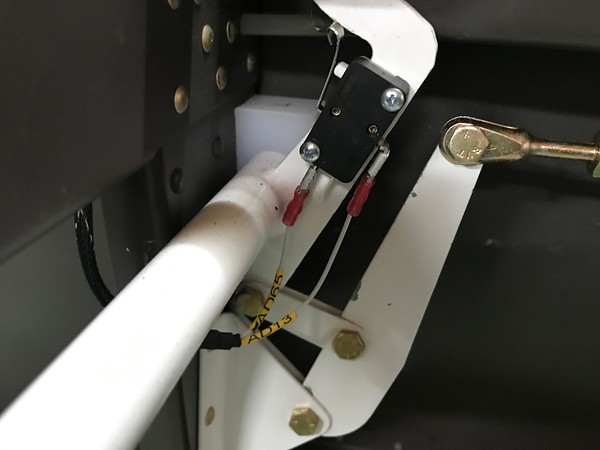

Everyone seems to have one. But how is it done? And what EXACTLY are you sensing? Contact between canopy and rail? Handle fully closed? Handle locked? I know there is a world of micro switches out there Installing one, or even two to sense close proximity of canopy and rail isn't theoretically hard, but I couldn't find a thread on exactly how anyone did it. Also, no doubt air loads may alter the fit of a canopy in flight, so I'd guess certain locations around the canopy perimeter would be more reliable than others. Or, maybe those are the exact location to keep an eye on? A single sensor, or more than one? In series, so if any one of them loses contact, I get the light? Inquiring minds want to know.

On the -14 it is a microswitch that is activated by the canopy locking pin.
The ones I've looked at are assuring the latch is engaged. (like what Mountainride said) So, you could have the canopy tipped uo and the latch closed and there would be no light. But you aren't going to take off like that.
The reminder is useful. I confess I took off unlatched., ONCE. I still don't have an indicator, but it's something your unlikely to do more than once. And that passenger will never let me live it down :(.
I think the only way it's of any value is to measure whether the latch is engaged or not. I ultimately decided it wasn't worth it for me, but how I would have done it on my 7 slider is a microswitch that got bumped by the latch hook when it was engaged.
Maybe your 8 is different, but couldn't really see any other location or method on a 7 slider that would show whether the canopy was actually latched or just slid closed, which I don't think I need a CAS message to tell me. I didn't like the idea of having to look at that micro switch front and center and so I decided to pass on it.
Not really needed in an RV-8. If you do somehow fail to look at the handle that is a few inches from your face and take off anyway with canopy shut but not latched, the airflow will hold the canopy down. If you take off with the canopy open all bets are off.

I can't answer for anything other than what I did on SuzieQ, an RV-4. There is a microswitch positioned so the canopy rail opens the microswitch (turning the RED light off) when the canopy is closed and locked. It is positioned to be pretty sensitive and the canopy has to be CLOSED to move the switch arm enough to open. It can be seen in the photograph in front of the nylon block that holds the canopy rail in the closed position. The canopy is in the TAXI position in the photo. The microswitch is held in place by a bracket that is bolted to the nylon block with the same bolts that hold the block in place. It has never failed and never turned on in flight. It is on my CHECK LIST in several places. The first line of my predeparture check list is CANOPY: DOWN AND LOCKED; SEAT BELTS: LOCKED (and the RED light is off!) BOOST PUMP: ON; FLAPS: SET 20 DEGREES; GAS: RIGHT TANK etc all of which I say out loud as I have done this so many times it is welded in my memory!.

Many ways to do this--I think there is another thread with ideas. I did this on my -7A tip-up by attaching micro-switches to the steel latch "fingers" that engage with the WD-622 canopy latch lug. When the fingers are completely engaged with the lugs, both switches switch on, and they're wired in series so if one or both are not on, I get a CAS message.
Closing the canopy and double checking both latches are checklist items, too, of course.
On my fastback I mounted a microswitch on the forward side of the front locking block behind the instrument panel. I fabricated a simple bracket to hold the microswitch in the correct position. When the locking pin is in the latched position, the contact is tripped and the latched signal is achieved.

That's what I like about my setup: the microswitch is not opened until the locking pin is FULL FORWARD!
