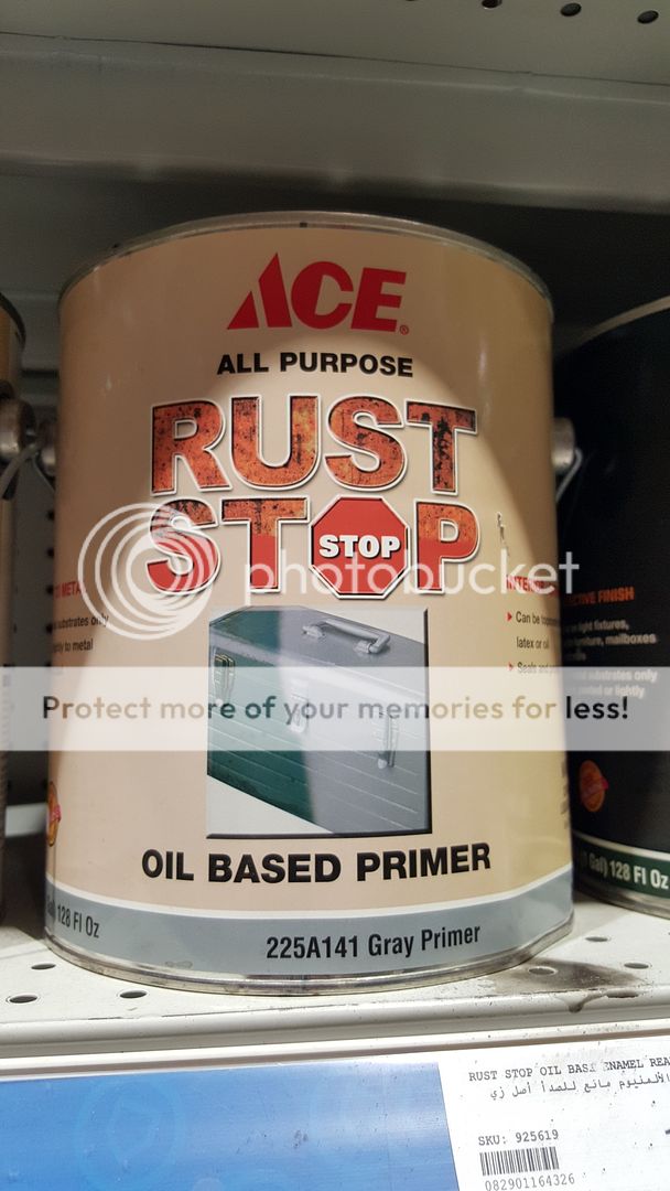

To make long story short I couldn't find primers mentioned around here where I live. I bought Bosch PFS 65 portable spray gun and found the below primer can in hardware store, do you think it is any good? Will it work?

I've never seen that before but based on its label, it looks like it may not be formulated for aluminum.
Primer
Do you know anybody that works in aircraft maintenance in Riyadh? They should be able to get you a primer that is approved for use on aluminum
Paint
Have you determined what type or brand of paint you intend to use? If so, then use the recommended primer that the paint recommends. Many paints will call out a specific primer. If it isn't going to be painted, then you may want to locate a primer that is specifically suited for aluminum.

The primer you show I'm pretty sure is for steel, not what you want.

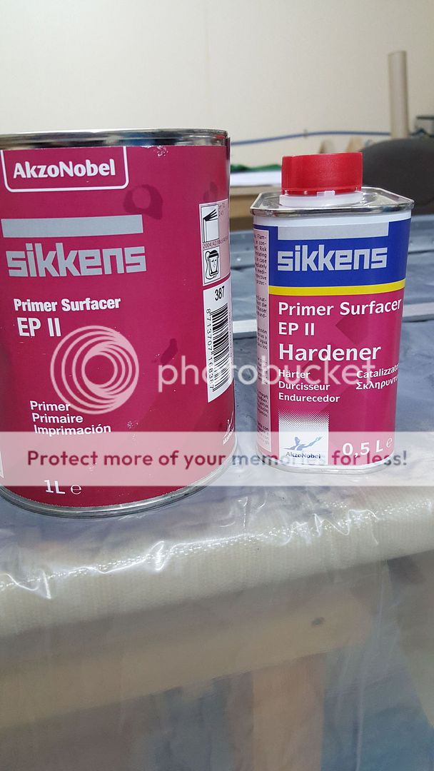

I had used different spray can primers with mixed results, but all of them didn't last many parts so I have to switch to something more economical with the wings coming up.
I went to auto parts store and they gave me this 2 part epoxy primer and they said it works with aluminum. It looks very nasty stuff :cool:
And here is the product home page:
http://www.sikkenscr.com/en/products/Primers_Fillers/Primer Surfacer EP II
The instructions say I have to use a reducer which I didn't buy. Will off the shelf thinner do the job?

Sorry to say, but you should have a chromate primer (zinc or strontium) or one that is a (MRP) magnesium rich primer. The MRP is harder to find, at least in the USA. PreKote and MRP are very good for corrosion resistance on 2024 (structural parts). It seems all military depots will carry some chromate primers or MRP.

The data sheet includes this statement "Due to the many different kinds of aluminum it is not possible to guarantee all types as suitable substrate." Also Primer surfacers tend to be thick to cover bodywork making them heavier than a straight primer.
