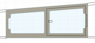

I want to put a compartment under the baggage area for tools -- that way I always have them with me but they aren't in the way. My plan is to put it between the left tunnel rib and the next rib towards the baggage door. Here is the area (note that this shows the right floor panel but I'd be modifying the left floor panel which is closer to the door).
A couple of notes. I don't plan to access this very often so I didn't want to mess with a hinge. The RV-10 is not aerobatic so I'm not worried about the lid having to withstand a lot of vertical force. But I do want to make sure the lid won't get damaged from a suitcase or similar being placed on top of it. I plan to line the entire compartment with foam (like a storage box) so that nothing can move around under the floor skin. I will also have carpet over this -- I will need to pull the carpet back to access the compartment. Therefore I think it is OK if the compartment is not perfectly flush.
Here is my plan so far and I'm looking for feedback:
They gray piece will be a 0.05-thick aluminum backing plate that would go under the floor skin. At the top and bottom I plan to rivet it between the standard floor and the rib flanges. This will make the floor just a little bit uneven (by 0.05"), but I'm thinking with carpet it won't be noticeable. Note that I drew the flanges of the ribs to the left and right of the piece. The piece will not go all the way to the ends of the compartment, instead it will end approximately 3-4" prior to the front and back of the area. I will flush rivet the edges on the left and right of the drawing to the floor above.
I hand-drew the lid on the right side showing what one of the two lids would look like. Each lid will have a flush latch on the inside and a "under tab" on the outside. The tab will fit under the backing plate as shown in the picture. Most of the lid will be resting on the backing plate, except where the tab slides in.
This is my first attempt at any major modifications and I wanted feedback.
  • I know the floor provides some structural support for the ribs and I wanted to make sure I don't compromise that. That's why I have this solid backing piece that rivets to the ribs and has the center support. I may want to put some additional strength under that center support that divides the two compartments.
  • I definitely need to reinforce the lids in some way. In the plans, there are some stiffeners under the floor in this area, but I don't think that's enough for this lid. Because the lid is not attached anywhere it won't have any tensile strength.
Any suggestions on reinforcing the lid? Build a frame out of angle iron? Use foam and fiberglass to build a fiberglass sandwich underneath?

For all the trouble you are going to, it would make sense to put a piano hinge on it, and flush latch.
Structurally, I would be more comfortable if the doubler was wider, and riveted to the original skin around the perimeter as you said.
Using the original hole pattern for the floor skin to the ribs would be fine. Along the front and back edges, if those aren't at a bulkhead or rib, put a piece of light angle on the back, something like 0.032 x 1" x 1".

I was thinking I didn't want the hinge to be sticking up, nor did I want to spend the money and weight for a flush hinge.
Yeah, exactly. In my drawing, the top and bottom edges will be riveted between the spar and the original floor of the cargo area. For the fore and aft edges (far left and far right in my drawing) I was going to just rivet to the floor but was considering some sort of structure under there.
Quite honestly, I don’t think this is a great idea. As others have said, gluing insulation onto the skin is an open invitation to trapping condensation and eventual corrosion. Remember the structure created by the wing skin, ribs, and floor creates a very strong box-like structure. Careful engineering is needed to be sure to retain the full strength. Finally, having a small tool box gives you some loading flexibility. Two men up front? Tool box aft end of baggage area. Four adults plus bags? May need to move toolbox forward to under the pilot’s legs, to keep cg in limits.
Edit: plus, weight on the baggage floor tends to load the rivets in shear, where they are very strong. Weight on the inside of the external skin will load the rivets, at least partially, in tension, where they are not quite as strong. This analysis is beyond my capability.

The basic idea is not a bad one at all however there are some improvements you could make to strengthen things up. It depends how carried away you want to get as to how you go about it. As Mr. Smith said - the doubler under the floor skin needs to be wider and I would place a double row of rivets around the perimeter.
Check out AC43-13 for some ideas on how to go about it.

I put a compartment in there. Doubler, double row of rivets. I used a hinged door. I used press to release latches. I would not do that again (the latches). I used locking top Tupperware boxes to contain anything that goes in there. I used a piece of 3/8” closed cell foam on the floor. It is not glued in a can be easily removed.
I used 025 for the door reinforced with 3/4” 032 angle. I would use at least 032 for the door.
So far I keep tie down ropes, some tools, and some spare parts there. It does get them off the baggage floor and the lock top boxes make sure nothing goes through the tunnel lightening holes.
