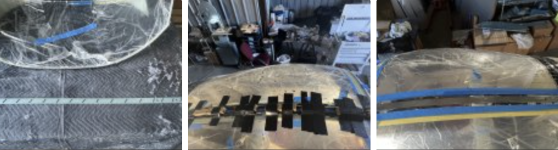

RE Sika slider C-653
…rapid_ascent reply
While many have decided to not to install the cover strip I decided I wanted to go ahead and install it. I used Sika as the adhesive and it went relatively well. It's a little tricky since there isn't much to position the cover strip or a way to really clamp it down.
To start off I purchased some 1/16" o-ring for use as a spacer for the Sika. I then used super glue to glue short pieces of the o-ring to the back side of the cover strip. I wasn't sure if this approach would work, but others here have suggested it so I gave it a try and it seemed to work.
Before the actual gluing process I cut some "clamping" blocks that I planned to use to hold the cover strip down. These were slightly narrower than the strip so they didn't touch the Sika. They were of varied lengths so that they would follow the contour of the canopy. My plan was to use Gorilla tape to hold the strip in place.
For the canopy latch hole I cut a short piece of 1/2" wood dowel and added a couple of wraps of shipping tape. Make it long enough so you can get a pair of pliers on it to twist it for removal.
In my case I had two aft holes for the handle that I plan to add. I glued the standoffs in place at the same time.
The other prep that I did was I calculated how big the notch in the Sika tip needed to be to get the right amount of material for the width of the strip. That also seemed to work pretty well.
The Sika is applied using the standard process. I inserted the wood dowel after the primer had been applied to that area so I would be able to remove it later. I added the cover strip to the canopy and then began my clamping. There was some minor squeeze out which I used a popsicle stick to clean up. The only problem areas were under my Gorilla tape. I went back and tried to clean those areas up too with mixed success.
I did end up going back doing a little touch up and then carefully sanding the finished edge. 220 grit seems to work fine for this. I'm happy with the results and glad that I added it.

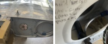

Rocket style fuel tank vent
I decided to vent the fuel tanks rocket style instead of re-entry into the fuselage. The one thing I didn’t want to do was to put the exit in the wing root fairing so I went thru the wing spar and exited out the bottom skin. I also added a tiny hole on top of the line just before it exits in...
