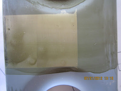

Read what you can about it on VAF but be sure and carefully read what Van says about it in chapter 5 of the build manual. One of the products Van recommends for priming is Sherwin Williams G60P2 Wash Primer. I did an informal test of it over scuffed, unscuffed, and primed with NAPA 7220 aluminum and couldn't tell any difference in the toughness or adhesion on the three sections.
