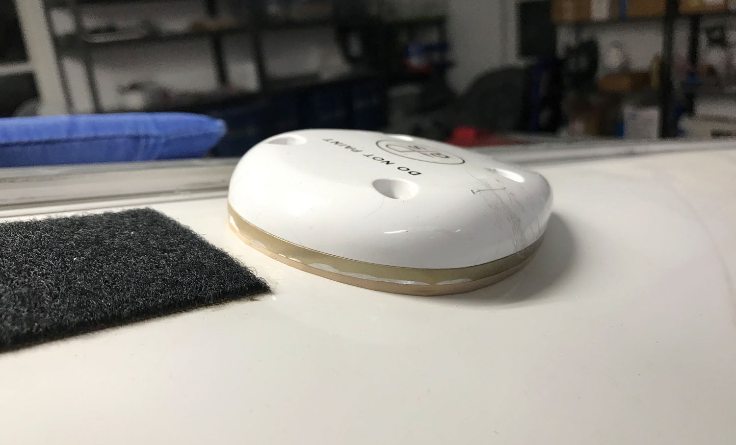

Thanks Carl. How did you achieve a snug fit with the Garmin antenna against the curved body?

Easy, it is pretty close if you do nothing. But add a washer on each of the screws on the “down” side of the fuselage between the antenna puck and the fuselage if you want it be exact.

Thanks for the reply. You must be Paul. I attached your article above after reading. I was thinking about Neoprene or some sort of rubber agent instead of the resin.
Mounting on a curve isn’t terribly hard - a little resin and micro and it goes on easy. I wrote an article for KP on it but you’ll have to search for it.
Love your article, but my confidence with resin on a painted airplane is low. I'll probably have to buy some materials and mess around a bit, but that's exactly where I want it and exactly how I would like to do it.
I bet I could 3D print something, but it would be worse, and probably require a couple revisions without a way to measure the curve exactly.
Try the sheet neoprene (with adhesive) from McMaster - that’s what I did on the Rocket and it has greater curvature than the -8 in that spot. I think I used 1/4” thick material. Easier and less permanent than the micro version. We learn with every airplane we do….IMG_0668.jpeg

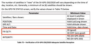

My RV-8 has the Dynon SV-GPS-2020 mounted on a shelf under the cowl as shown below. Works well. 1730 Hobbs Hours so far with no problems. Don't mount it too close to the firewall such that it is partially blocked. As far as alignment/orientation is concerned, it just has to have a good view of the sky.
Screenshot showing typical GPS fix status. All good, i.e., “Fix Quality: 3D Diff".
My previous RV-8 had a Garmin GPS antenna mounted on the turtledeck under the canopy:
"Works Well" is a highly subjective term. It appears many folks are more concerned with cosmetics than performance.
I did say “Works well", but backed that up with a screenshot showing my typical GPS fix status, i.e., “Fix Quality: 3D Diff".
From the SkyView Installation Guide:

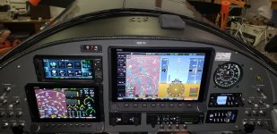

I mounted my Garmin WAAS antenna on the glareshield, mostly because I ran out of space in my firewall pass-throughs. I made a little base for it out of epoxy and micro, and pained it black. I covered the antenna in black vinyl because I wasn't as bold as Paul. Since the antenna sits 12" from the navigator, I didn't need the minimum length of RG400, so I just coiled excess under the glareshield.
