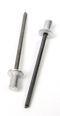

Is there a best method to use when pulling this type rivet that will produce a respectable outcome? I have about 1 out of 5 that resemble a decent finished rivet. The rest end up looking bad and they also plug up the rivetgun nosepiece to where you have to unscrew it and pound out the rivet slag.
I’m using the smallest nose piece of 3/32”. The mandrel of the rivet is .063”.
I drilled a .068” hole in the side of a washer and slid over the mandrel and then pulled the rivet with similar results. It did make it easier to punch out the metal slag from the rivet instead of removing the nosepiece.
What am I doing wrong?
Thanks, Dave

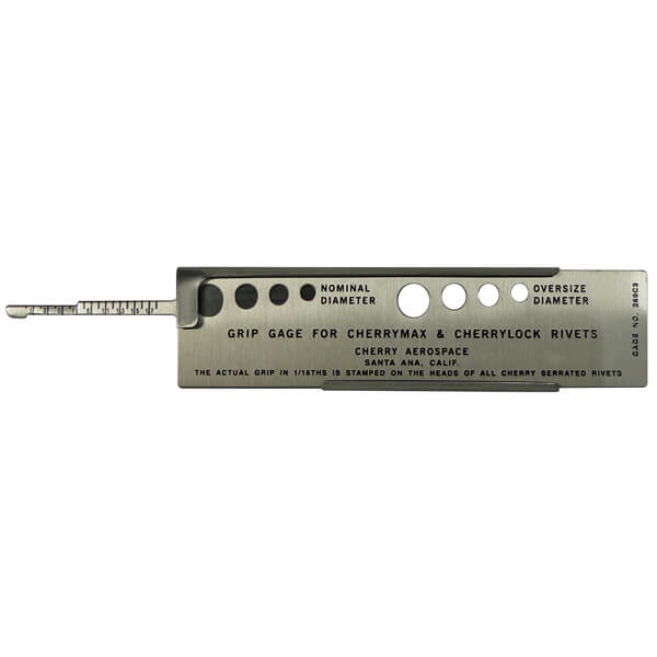

Not saying this is your issue; but, two things that will certainly yield the results you're experiencing:
- Wrong grip length of fastener i.e. too long. (Most) Blind rivet mandrels are designed to break on the high side of any locking feature and below the top of the head. Yes, I know I'm being Captain Obvious here.
- If you apply any side or angle load with the puller relative to the surface. This adds stress on the mandrel at the I/F between the tool and head.
I'd double check the stack height and rivet lengths. I'd double check my technique (alignment). If both are good, I'd assume a tool or fastener quality issue. As the fastener lots get QC tested and they tend to be pretty forgiving, it's not the way I'd bet. I'd then consider borrowing a different puller and see if that makes a difference.
As mentioned, not saying this is the issue but can't think of another variable. Best of luck. Let us know.

I think you should investigate whether you actually have AD42H rivets that you think are AD41H.
Section 5 of the Manual has a rivet/hardware identification chart that you should be able to check the rivet against.
