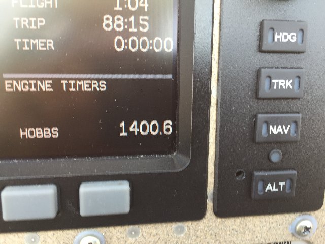

Fantastic... If you wouldn't mind, can you tell us a little bit about maintenance required to get that many hours. Engine using any oil, type oil used, gearbox overhaul, prop overhaul, ignition, carbs, basic engine stuff. I'm at 500TT and still smiling every flight.
What I can remember - -
Uses about a quart of oil in 100 hours. Aeroshell Sport plus 4 oil. Change oil at 100 hours. Never had 100 LL in it. Prop original. Updated front hub half. Had to replace both GREEN stripe ign boxes. Yellow Stripe have been good. Never changed floats. Replaced battery at 10 years and 1 month. Chose to replace flywheel very recently. ( lot of work ). Gear box seems good. I took it apart a few months ago. Always inside good hangar. Have engine heater and oil thermostat. "Heater Damper Door" is best of my inventions for comfort. Few paint marks here and there. Still very dependable to me.

I do compression check at annual - -
and it is 78 - 79 / 80. Nothing much ever changes. A few minor improvements could have made this little motor near perfect. Initially, better soft-start ign boxes. Continued making the floats the same, and latest flywheel. I consider it very good now that I have fixed the above things. I would not be surprised to see this motor go to 3,000 hours.
Also, I usually do not stress the engine much. I usually allow plenty of time to get to destination. 4900 - 5000 rpm is an easy cruise speed. Sometimes even slower. Rarely run near 5500.
