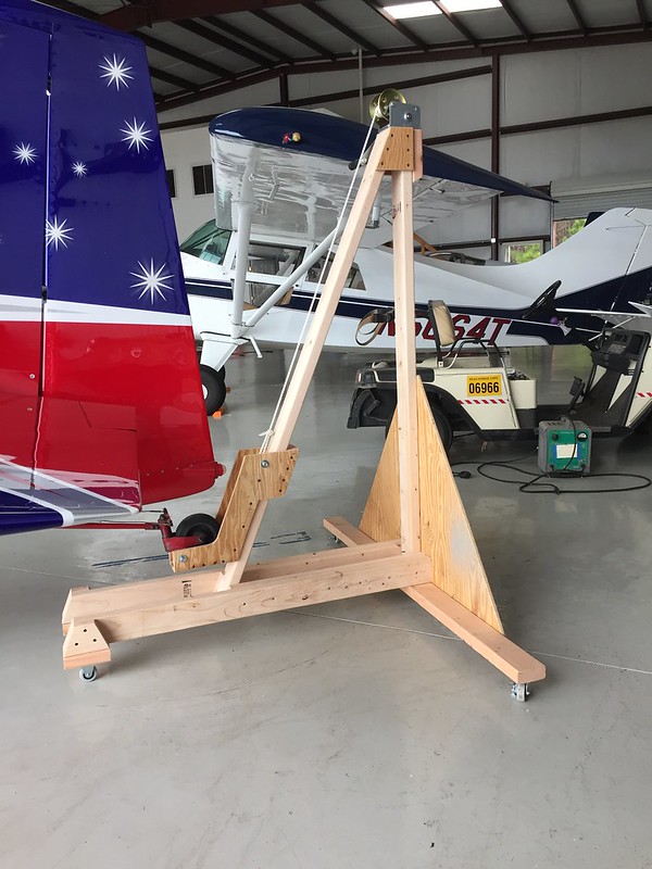

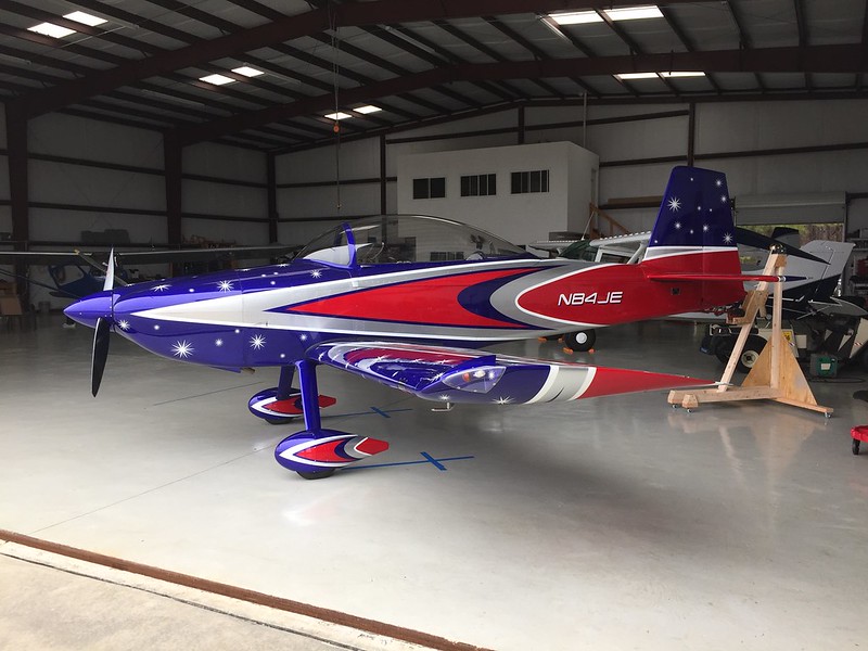

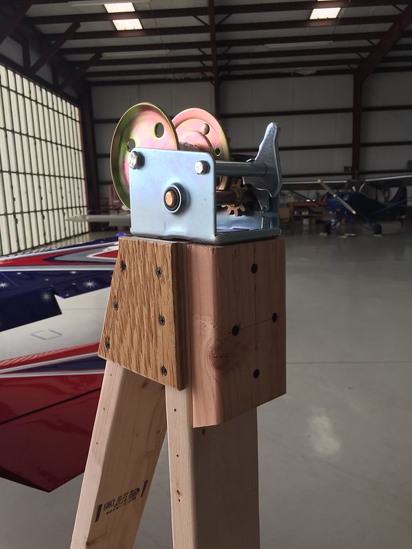

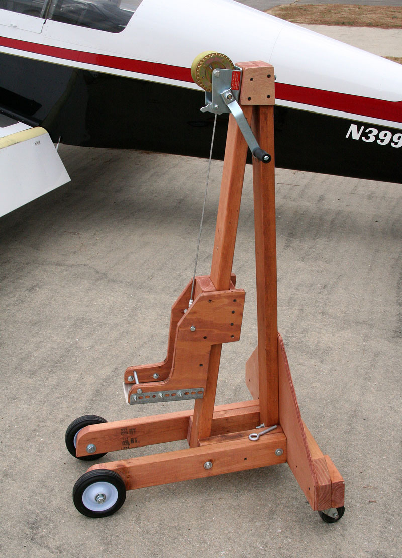

Refined the wood tailwheel lift to make it easier to roll the aircraft's tailwheel into position. The bottom of the dolly was originally wood but it's been replaced with steel angle and plate which sits at floor level. It's amazing how well such a simple device works. :)
Good upgrade, Sam! As I usually do--with alternators, ADS-B installations, and I'm sure a number of other things--I'll be following in your footsteps in my first free weekend! Thanks for being a trailblazer!
Steve

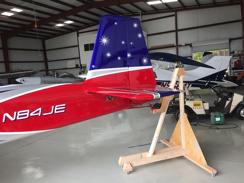

This seems lke a really naive question, but do you need to lift the tail often? I'm sure all will become clear once I switch from builder to operator...
I understand why you're asking. When you're building, the tail isn't heavy and there's no reason to do maintenance, but when you're done, that tail will weigh a lot more and you'll need to get it off the floor for tail wheel maintenance, leveling the plane for oil changes and other reasons, etc. Trying to pick up the tail with one hand while you slip a support under it, can be stressful for your back and shoulders, especially if you're getting older as some of us are!

To add a little to Marks [spot on] comment, the rudder is in the way of getting over the top to pick it up straight. My TW is around 60 lb at flight attitude, but 90 lb on the ground. During calibration phase, you will need to check fuel up and down, and do fuel flow testing the same, and some EFIS require flight attitude for calibration as well. It has been a lot of ups and downs for me.

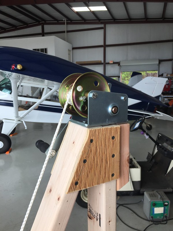

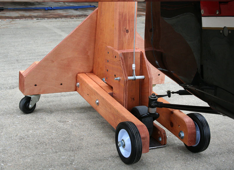

Design shamelessly stolen from Sam with the addition of a $3 Harbor Freight pulley on the top to allow the winch to be on the back. Fun weekend project. Thanks Sam!
Just a couple additional comments for anyone who may build one using a pulley...
1. The higher you can get the pulley the better. If you look closely at my picture, the angle of the cable just slightly rubs against the wood front and back. Not a big deal, but not perfect.
2. More importantly, the angle of the cable where it attaches to the tailwheelwheel tray/lift is a bit extreme, sometimes causing the wood-on-wood sliding assembly to bind. I'm going to relocate the attach bolt closer to the frame so that the cable pulls the assembly straighter up.

A couple of observations:
With the winch located where it is on my lift there are no problems with cable or slide binding, the cable remains parallel to the ramp at all times. The tail of the RV-6 can still be lifted up past horizontal.
Not having a pulley also reduces flying weight. :D :D

No need to beat yourself up....I had a pulley I was intending to use until I started looking closely at the geometry. I'm always surprised at how much simpler a project gets the longer I study it. :)
But there are several ways to skin this mule, you built a nice lift!

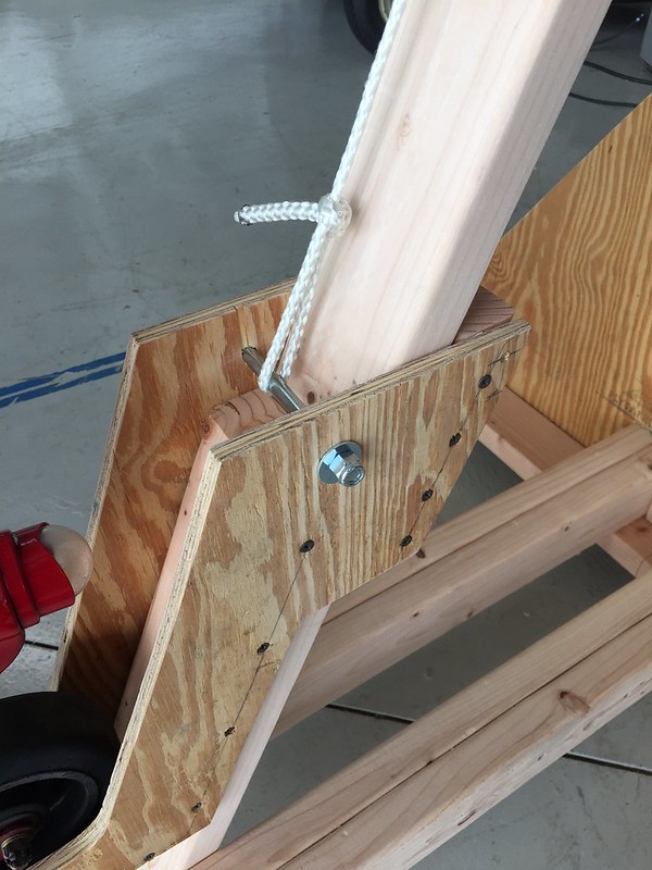

If you look carefully at Sam's pictures, above, you'll see that there is an eyebolt loose on the base. It looks like he inserts that in a hole in the frame upright just under the tailwheel to serve as a safety.
All that said, there's not much weight on the lift when the tail is up high, so I wouldn't be too worried about the regular winch being overstressed. The winch I'm using is rated for 1200#.

Not implying anything is wrong with the design. Just a different view on a fail-safe lift and admittedly a product of my own paranoia. The weight is insignificant but a absolute drop would not be. I look at the arm on that tail spring and the last two bulkheads every time I lift them onto a sawhorse for maintenance...

As mentioned by Steve, if you look carefully at this photo you can see the eyebolt safety inserted into the ramp....that lift ain't failing. But hey...if it did fall it wouldn't be as violent as some of my landings! :D :D

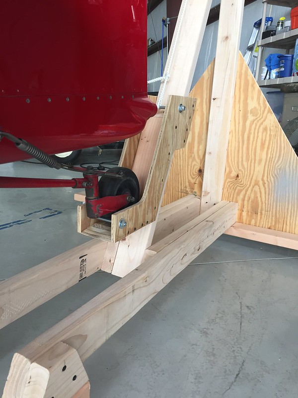

I ?borrowed? this idea:). The second picture is a slight modification I needed to eliminate binding while returning the tail to the floor.

I “borrowed” this idea:). The second picture is a slight modification I needed to eliminate binding while returning the tail to the floor.

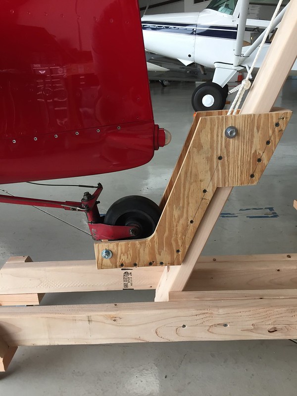

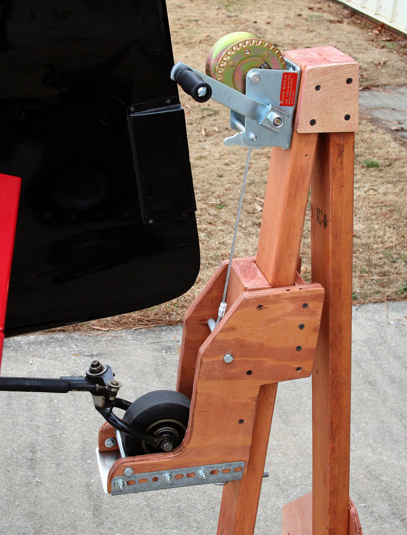

There is more going on with these simple lifts in regard to engineering than might be at first apparent. My engineering background is limited to the shadetree variety but some simple analysis might reveal why some wood lifts slide effortlessly and others may bind.
If binding occurs on the aft slide block then more than likely the cable attachment needs to be closer to the tailwheel centerline. This will decrease the length of the arm supporting weight and the resulting load on the aft block.
Compare the cable attachment geometry on these two lifts:
Mine (cable aligned more or less even with rear of tailwheel, and the cable parallel with the ramp):
Marvin's (lift strap aligned with a point several inches aft of the tailwheel):
The dolly slides up and down with no binding on my lift and I suspect it is because the cable is closer to the tailwheel. If Marvin moves the attachment of the strap closer to the tailwheel (shorten the load arm and transfer weight from the rear slide block) I bet it will operate more smoothly. :)
I realize this stuff is pretty insignificant in the grand scheme of things but it is still interesting to play with. As a side note--I'm always amazed at how huge structures in antiquity were constructed with highly engineered simple machines.....them folks were smart!

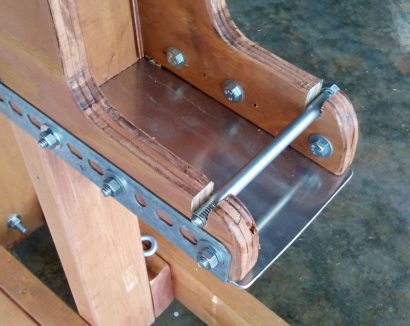

Slide
Might just take a piece of nylon sheet on the bottom inside of it as that's where most of the force is against the vertical piece.
Or a piece of the UHMW tape left over from protecting your aft wing skin from your flaps...

I agree with Sam that the lift works fine wood on wood. In my case I have a tail light and an 8” tire that did not allow moving the attach point forward like Sam’s because the strap would rub. If you look closely at the picture you will notice my tail wheel axle is actually a few inches forward of where I intended. My choices were to increase the angle of the lift to clear the tail light or increase the length of the backside of the moveable trolly.
When I built one of these years ago, instead of the block in the back that slides, I used a bolt with a bunch of plywood wheels (pieces from another project cut using a hole saw) to allow for easier movement.
Also, instead of a bolt keeping the tailwheel in, I just left the metal plate with a gap at the back, so the tailwheel drops into that space when the tail is lifted.

You are fighting the 7:1 ratio. This is ancient engineering.
Your slide must be more vertical or your tail wheel block must be taller. This will fix your problem.

Very nice, Karl! Consider using a "safety pin" when you start hoisting your plane.
