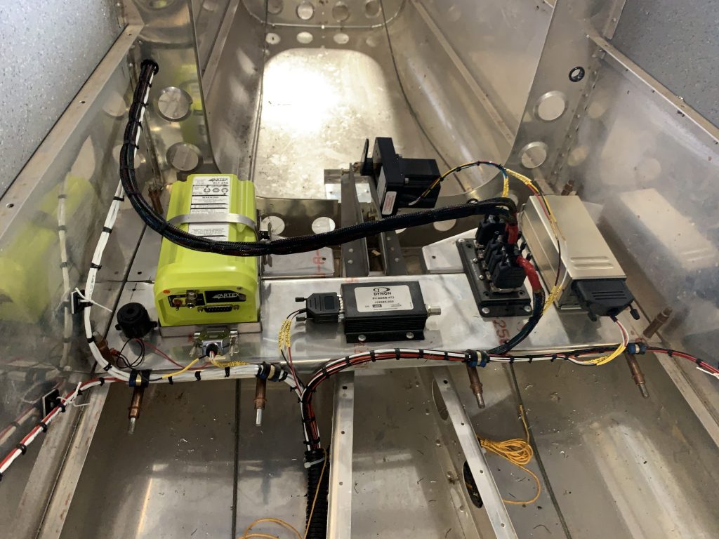

In a general sense, my wiring runs out from the panel area on the right side, down the right gear tower, through the spar on the right side, through conduit under the seat floors back to behind the baggage area. From there it splits, one branch moving laterally in front of the avionics shelf I built, the other continuing aft to the tail.
Wire bundle coming through the spar to the area of the right rear footwell, and entering the conduit. Notice here the bundle also splits to go across to the left side for wing connections and such:

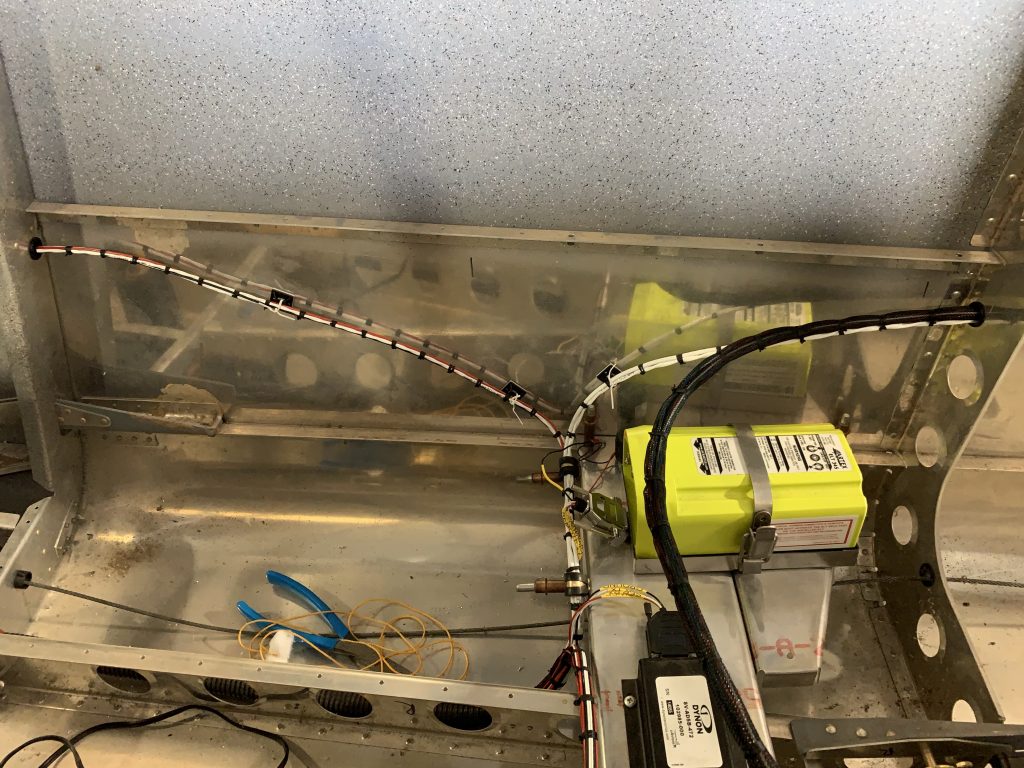

Bundle exiting the conduit; this will be just aft of the baggage skin once it's installed. You can see how the bundle branches right to serve the shelf, and left to connect the ELT and then proceed aft:
Different angle of the rear avionics shelf wiring. Notice there's also a branch that goes forward, under the right armrest; this will serve the rear headset jacks and charge port:

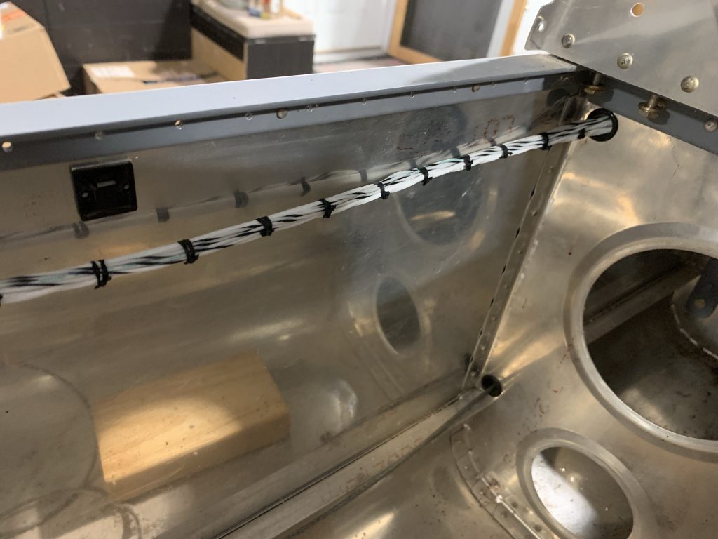

Further aft, the bundle uses the preexisting bulkhead holes up under the longeron:

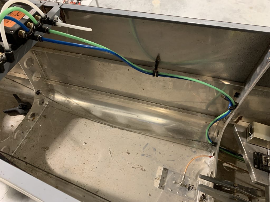

I don't have any static line routing to show, since my static lines just go to the Dynon ADAHRS in the tail, but the pitot/AoA line routing may be somewhat instructive. Those lines are routed forward and down along the left skin, to pass under the avionics shelf:

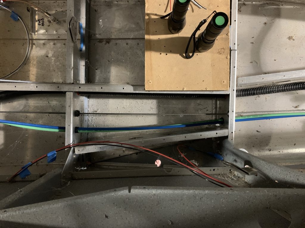

Then on forward along the bottom skin, through bulkheads as required:
Of course, since these just have to go to the left wing, that's where the fun ends. You could do this with a static line, and route it through the spar and up the left gear tower, or you could also use the prepunched holes high under the left longeron to route it forward. Honestly the latter is probably better suited to running a static line to the panel.

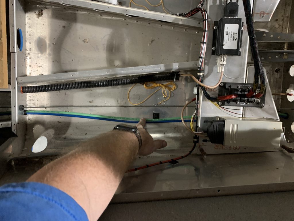

Thank you Phillip, this is exactly what I was looking for. It looks like you added the holes for the right side conduit under the floor to mirror the existing ones on the left?
Yup, I put in conduit runs on both sides. I know I had to make holes on one side, though I don't recall specifically that it was the right, and I'm not finding the relevant build log entry off the bat.
The right side is my main wiring route, and honestly it's so full that I'm skeptical that I'd ever pull any additional wires through for retrofit work later on. The left side is mainly there "just in case," but at the moment it does house a coax run from the ADS-B receiver on the rear avionics shelf to the antenna mounted just in front of the rear seat.
