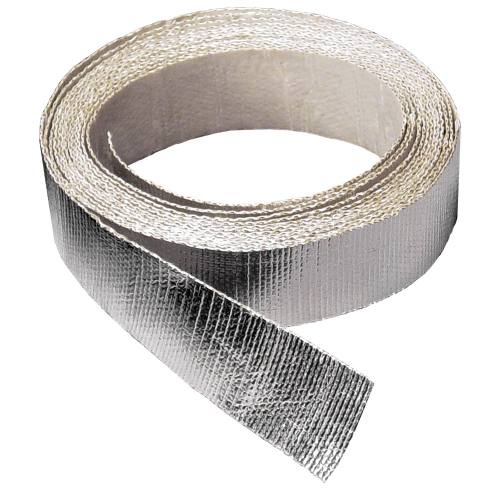

Blocking off the oil cooler and radiator doesn't have to be elaborate.
Just put some heat tape on there and adjust the amount to get the temperatures that you want.
