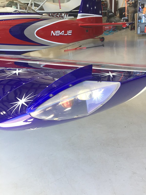

I have the W-415 flat topped Hoerner style wing tips and I am in need of replacement lenses. Has anyone found a source for these yet? The fiberglass insert on mine are relatively small and the aft part is raked back about 120 degrees. It's definitely not the RMD style. Does anyone have contact info for Sound Mfg?

The vertical piece above the lens is a strobe light fence of my own creation.
Polish Out the Haze
The answer is in the post right above yours. The lens they sell looks just like what I got in the kit.
I have the same tips as you (mine are from 1997) and I had good success polishing out the haze with Flitz. I'm sure other plastic polishes would work well too. So that's another option.
Beautiful paint btw.

Hi Laird. Thanks for your response. I ordered those from Flyboy and they were not the correct ones. I had to return them. I?ve been on the phone with them a couple of times and they don?t carry those same lenses.
The problem isn?t polishing them. The problem is that someone bumped into my airplane an actually broke the lens. I have another lens that has a little melted depression from the heat generated by the incandescent lamps which I am replacing with LEDs soon.
