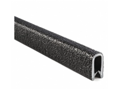

Try this
I used automobile door edge trim as a PERMANENT replacement for Van's rubber seals. I tried gluing Van's seals on with every glue known to man and still had the stuff come off at the most inopportune time. The noise it makes when the end comes loose and flaps against the fuselage is very disturbing! These door edge seals fit tight and never come loose. I never noticed any change in aerodynamic properties.
