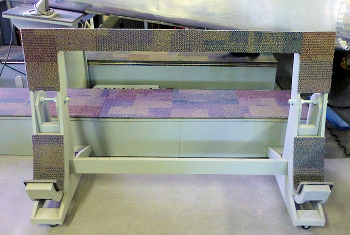

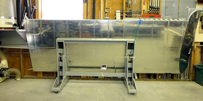

This wing cradle rotates at the bolt to turn into a wing table.
Rotate the wing to the horizontal position then roll the cradle to install
the wing
Works fine, a one man operation.
The second cradle is the same and designed to store within the spacing of
the first cradle.
It take up the same footprint as a cradle that holds two wings.
All production rights reserved.
