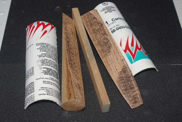

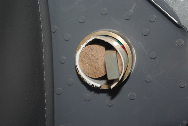

Poor man's tube expander
My wings were difficult to install after the seal strips went on the fuselage sides even though the gap between the wing skins and fuselage was as per the plans. As the wings were painted I didn't want to do any surgery on them, so I came up with this cheap (very) homemade `tube expander' to ease the wings into position. Took about five minutes to make the wedges out of a broom handle, cut up an old silicone sealant tube and find a suitable timber spacer to go between the wedges. Made it easy to line up the bushings without damaging them and tap the pins in with a rubber mallet. Thought it might be worth posting in case anyone else has a similar problem.
