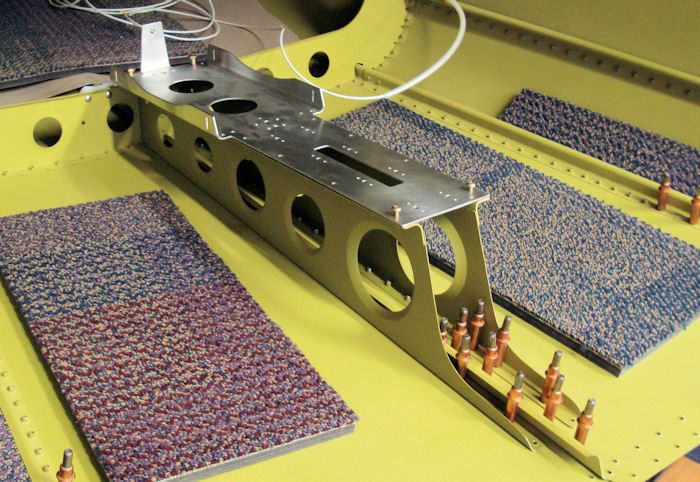

I added RV10 Battery Ribs to my 12
Take a look at this link for the RV10 parts I used.
I will also use a jab or a UL engine.
http://www.joesrv12.com/Builder Log/al_05_01.htm
http://www.joesrv12.com/Builder Log/al_05_02.htm

Battery mount
Joe Dallas, Thanks for the parts list and pictures. Oren had sent pictures but not the parts list, a great help.
Thank you

Battery in Back
Ted
Oren had to cut off the front of the bottom flange to install in his 12 as installing the rivets with the servo in place would be difficult.
The extension on the bottom flange will help transfer more moment to the Baggage Bulkhead on a hard landing and if possible should be left on.
Good Luck
Note: Oren said he added small angles to the sides
