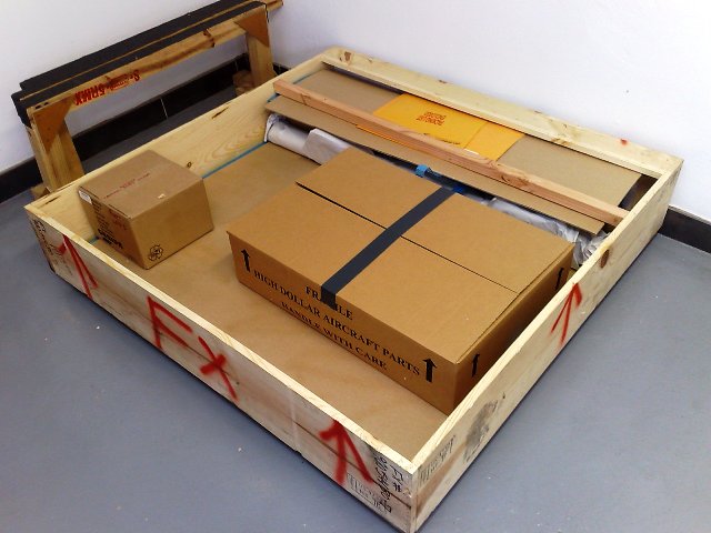

Jim Devlin - Wing Kit No. 84
Wing kit No. 84 safely received by (very expensive) airfreight in NE England. Unfortunately I am stuck at work in Azerbaijan and it will be late September before I get a chance to play with it.
No website as yet but will get around to it.
