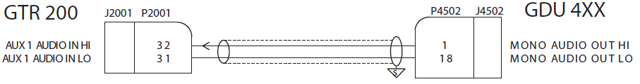

Wiring my aux audio systems into my GTR-200 (via an Approach Fast Stack wiring harness/hub), I could attach the incoming audio directly to the harness, but an old seadaddy taught me to always have a connector between a
In this case (if I have it right) the audio Hi/Lo comes out of the GTR harness. Lo goes to the ground, and Hi goes to the audio output (into the aux radio input). I could just run the Lo wire from the harness to the ground terminal strip, and solder the Hi wires together. But if I ever have to remove the system, I'd have to cut the Hi wire and resolder it when return it.
So it seems I should put at least a single connector in the Hi wire, or am I overthinking it?
TIA

Don't forget to follow the Garmin installation manual guidance for audio wiring connections to the various devices in the system.
For example, when you connect the alert audio from your GDU 4XX display to the AUX1 or AUX2 audio input on your GTR 200 radio, you will be using a dedicated shielded, twisted pair with the shield connected on one end to the backshell connector on the GDU 4XX display.
Wiring is never improved by adding any extra unnecessary connections in series between the signal source and the signal destination, so avoid any temptation to add extra connectors or wire through any junction box.

The Garmin GTR-200 uses a 37 pin D-Sub Connector. No need to add connections. If radio replacement with something else is needed, you can simply "unplug" the affected pins from the D-Sub connector.
D-Sub connectors are very common in avionics. If the replacement radio also uses this style of connector, it's a simple matter to simply transfer the pins. If the replacement uses another style of connection at the rear of the radio, just cut the D-Sub pins off and install the needed pins.
