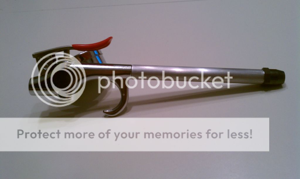

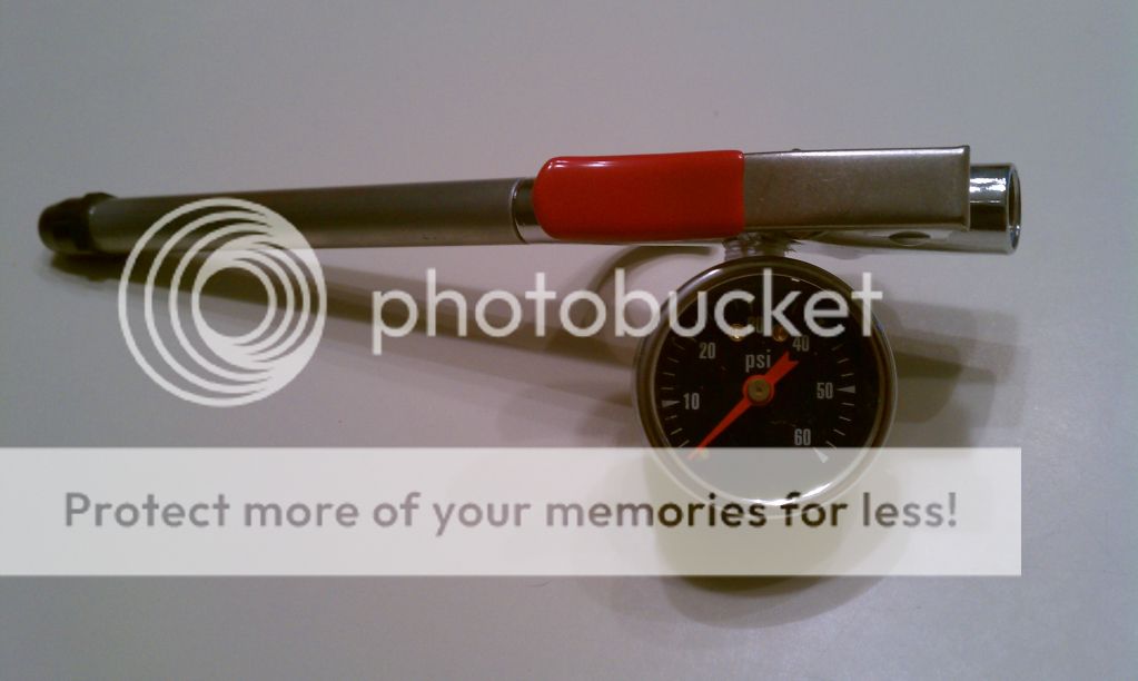

Those wheel pants look great, but today I had a low tire and had to add air. What a pain in the butt compared to my Cherokee. Has anybody come up with a convenient way to add air? I thought about a door or access cover, but it seems like I wouldn't be able to reach the cap the get it off the stem. How about extensions on the stems? Any ideas, guys?
Drill a 7/8" or 1" hole to match up with the valve stem. Use a snap in plug from Home Depot to cover the hole. Use a straight piece of rubber hose to install and remove the valve cap and use a screw on valve stem extension to add air.
Total, you'll spend $15, and your biggest challenge will be finding the correct distance from the axle centerline to drill the hole.
Try one of these!
Or you could order one of these from Cleveland Tools.:)
Oh and leave the valve stem caps off!;)

The outboard fairing mount, forward section has a hole in it large enough to insert and use the inline airchuck previously described. Transfer that hole to the front outboard wheel pant and drill it. Use the aforementioned snap plug and your done. I filled my tubes with nitrogen and it lasts much, much longer between fillings.

Also Order the valve cap tool . It works great even with the yellow valve stem caps (a little larger) with a little fine tuning with a unibit.
I carry the extension and cap tool in the plane in case I am out flying and need air. The gauge tire inflation tool in the hanger.
Item #: VSSET
$22.00
Mark you tires with a vertical mark to align when rolling the plane to get to the valve stem ( I used silver sharpie )

If you use an air nozzle that has a manual flow valve (like the one from Cleveland Tool) and give a blast of air before pushing the nozzle tight on the valve stem, it will blow all of the crud out of the valve stem before blowing it inside. I have been doing this for over 20 years on RV's and have never had a valve leak.
