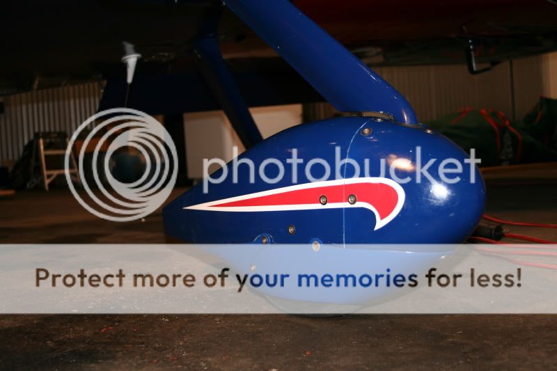

I don't know how you landed or how you installed your fairings but I do have some experience with close fitting openings on wheel fairings for the purpose of increasing speed.
You can design fairing in such a way the exposed surface of the tire is no more than a continuation of the line of the fairing. Someone just sitting and thinking in gross practical terms might think otherwise but if you experiment and test and measure and modify and repeat you can get past that limited view.
The tire to fairing dynamics change when the bottom of the fairing gets closer to the ground and here are a couple of observations:
- The interference angles get much lower because the fairing interface is nearly tangent to the rotating surface of the tire. The front of the tire and the fairing can be in actual contact with weight off of the wheels. The same is true of the side interface. The rear is more of a challenge because the surface of the tire is rotating directly into the fairing edge there like a rotating piece of wood in a lath turning directly into the cutting tool. This can be dealt with a little care in the shape of the fairing edge down a little there to avoid a hard edge contact - shape the inner surface so it is more tangent to the rotating surface of the tire.
- when weight is on the wheels the deformation is very interesting - the tire compresses up into the fairing where the flare out is above the fairing edges. This is where the fairings are wider and can easily accommodate the wider tire. The way most wheel fairings are installed up high on the tires reduces the bare tire drag and provide normal operational clearances for big chocks, foreign objects on the surface and rough surface but they do not maximize the drag reduction or minimize the need for clearance gaps. If those fairings were extended down almost to the ground, the best speed configuration can be achieved.
To get the best of both worlds on our RV-6A I developed subfairings for racing in the Sport Air Race League (www.sportairrace.org) cross country air races a couple of years ago. The idea was to install them for racing and remove them for normal operations. They turned out to be so trouble free that I simply leave them on all the time. In instances where I have scraped the nose gear subfairing the damage has been easily reparable and caused no damage to the main fairing. The net gain in speed was approximately 3 kts over the original Van’s fairing configuration. Below is a photo of my latest nose wheel fairing configuration. Unfortunately my paint supplier mixed the wrong shade of imron in the latest can of paint I bought from him.

Wow, nice stuff to know! I sure want to make such an added fairing for my 12 since I will practically never land on rough runways anyhow. Did you do that for the mains as well?
I would appreciate any guidance for making a mold for that.
Yes I did
There should be a thread ib the forum describing the development. Look for subfairing.
Bob Axsom
