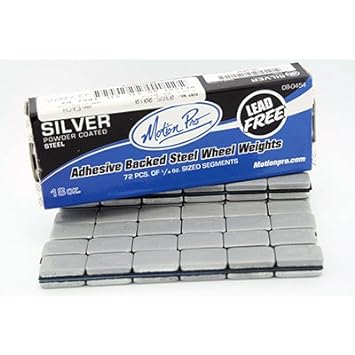

These are the ones I use. They are a .25 oz each and are small enough to peel and stick just about anywhere. They can be stacked on each other to.;)
http://www.amazon.com/Motion-Pro-Silver-Weights-Motorcycle/dp/B007KPTM02/ref=sr_1_2?ie=UTF8&qid=1425998918&sr=8-2&keywords=Motion+Pro+08-0454+Silver+Steel+Wheel+Weight
Thanks. I tried putting them inside the holes, but as Murphy would have it the solid structure is exactly where I want to put them. The RTV idea sounds interesting. The surface of the metal doesn't seem as "adhesive friendly" as the main wheels no matter how much degreasing I do.
