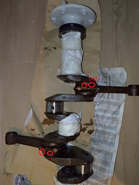

Thank you Bob and Larry,

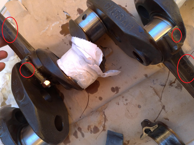

I will place them in the same positions. However, I arrived another problem. I saw that serials of the rods much match and face forward the sump. I installed rod 3 and was installed rod 1 now. Serial down and the dot/notch up. However, this ended up putting on number 3 the dot facing the rear of the engine and the numbers can be read from the flange and the number 1 putting the dot facing the flange and the numbers can be read from the rear. Can you help me find what is wrong? Thanks, Filipe
One of them is backwards. Don't know which because I can't see the whole crank, but they should both look the same when sitting on the same side of the crankshaft.
If one I turn opposite I will have the numbers up and the dots/notche to the sump.
This is the picture of all the crankshaft.
Redid n3, now n1 and n3 have the dots/notches to one side and n2 and n4 to the opposite side. I think this is normal, right?

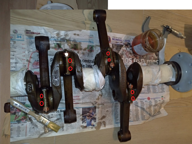

Now that we've thoroughly covered "don't swap the rod caps", so let's go back to the last photo. Per the manual, the numbers should face down, toward the sump. Number 1 is the right front cylinder. See the error?
Hello Dan.
As per the photo all the numbers are facing down. My red circles are the dots/markers/notches, do not know the name in English since it is not my main language. But the numbers are down and the dots up. Do not see the mistake, can you point me?
Filipe
Hello Dan.
Filipe
Ok then, you're good. I was mistaken; thought you had numbers up.
Thanks Dan Maybe I expressed myself wrong. Happy all is good. Measured journal diameter, rod with bearing Id.gap and side clearance all inside the values. Torque all 100 by 100 steps to a total of 480.
Filipe
