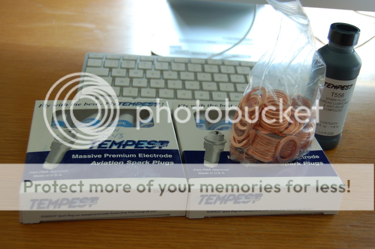

Can someone tell what the correct procedure to put on plug thread I was on the understanding of putting on antiseize but a of Lamies down under say just put oil on the threads

If you can find this stuff in Australia, it works very well on 18mm massive electrode aviation spark plugs. I've been using it for almost 14 years.

There's lots of warnings around the internet about never using any copper-based anti-sieze compound on spark plugs due to the risk of causing a short-circuit if any gets into the plug gap.
Anti seize. You would have to be a moron to apply enough to short out plug. Graphite is conductive also is it not?

From a Tempest engineer
Always replace the copper gasket with a new one every time the plugs are removed. The gasket flattens once the torque is applied and it can never be reused and take the appropriate shape. Also, copper has heat sync properties which assure the heat from the plug core nose is dissipated properly. Improper heat dissipation effectively changes the heat rating of the plug and can, in severe case, cause pre-ignition.
Anti-seize compound on the spark plug threads is also very important. Not only does it allow easier removal of the plugs, but jt also assures proper torque when installing the plugs.
Copper gaskets can be reused if they are heat treated before reuse. New gaskets are relatively soft and pliable. When torqued and exposed to heat from the engine running, they harden and are no longer able to conform to the spark plug seat if removed like when they were new and pliable. If you take these used, hardened gasket and heat them ( I use a piece of safety wire strung through several gaskets) with a torch, you can restore its original properties. Heat them with a plumbers torch until they glow cherry red, and then douse them in a bucket of cold water. They will come out as soft as they were in the beginning. Just to be sure, take one of these re-heat treated gaskets in your hand and try to bend it. You'll find out it's quite easy. These used gaskets are ready for use. Try a little scotch brite action on them if you want them to be shiney again (for whatever reason).

I've used Permatex paste antiseize....put a blob in an old film canister ( remember those?) and took an old solder brush, cut off most of the bristles, except about 1/8".
dab into the film can, drag around the perimeter of the plug thread, at least 2 threads from the nose, per some spec I read, and hand start it in the hole, with a new or freshly annealed washer.

I second what Scott said, I been bending wrenches for many years and have always reused the copper gaskets, just put a coat hanger through them and heat until red hot then quench them. Also. the Champion anti-seize is the stuff most mechanics use, just leave the last few threads of the plug untouched.
Scott,
I was going to call you out on this but did my research first. I have always Annealed copper with a slow cool not a quenching with cool water. I believed that cooling slowly was the only way. I found this.
Annealing, in metallurgy and materials science, is a heat treatment that alters the physical and sometimes chemical properties of a material to increase its ductility and to make it more workable. It involves heating a material to above its critical temperature, maintaining a suitable temperature, and then cooling. Annealing can induce ductility, soften material, relieve internal stresses, refine the structure by making it homogeneous, and improve cold working properties.
In the cases of copper, steel, silver, and brass, this process is performed by heating the material (generally until glowing) for a while and then slowly letting it cool to room temperature in still air. Copper, silver[1] and brass can be cooled slowly in air, or quickly by quenching in water, unlike ferrous metals, such as steel, which must be cooled slowly to anneal. In this fashion, the metal is softened and prepared for further work—such as shaping, stamping, or forming.
