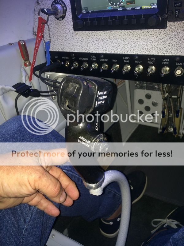

Just a little daydreaming between rivets.
What stick grip did you use and how difficult was it to mount?
Bob
Infinity. No real issues if you read and follow the directions. Also plan for some rotation to fit the angle of your arm/wrist on the grip for comfort.
I chose the RAY ALLEN G101 STICK GRIP from Aircraft Spruce. It was stone simple to mount, seems to be comfortable and long lasting. One bonus to me was I ordered another soft rubber part only, it fits the flap handle and is therefore attractively matched to the control sticks.
A benefit of the Ray Allens is you get high quality tactile switches to replace the cheapo original PTT switches.
Used the ray allen grips but getting 6 wires in was very difficult.
I use trim , autopilot engage/disengage and fuel pump on/off from the sticks.
Great grips
As much as I would have liked more functions on the stick, threading the wires was going to be a hassle for sure. Having flown a 12, I found the trim on the panel to be very nice, would recommend using only the PTT model.
I did what Don did.

The Ray Allen G101, the PTT switch "works a treat" (as our friends in the UK like to say);)
Each grip comes packed with adapters for stick size and all hardware needed:
The 24 ga pigtails have to be soldered to the switch:
You need to drill and tap a hole for the setscrew that secures the grip to the stick:
You can certainly use the PTT switches that come in the kit and grips from a bicycle shop; I did that initially but had intermittent issues with one of my switches and I was always getting my trousers caught on the switches sticking up when getting in and out of the plane. These are better.
I used the same grips as Tony but I installed the soft rubber opposite from what's shown. Just my preference for feel. I like sliding my hand down on the stick.

Ray Allens here. PTT and trim and after reading this thread think i will put the auto pilot disconnect on there saving some panel space.
Tosten CS-8 grip
I bought two of these and wired both sides all 8 buttons. They fit well. I haven't finished the airplane, so I can't comment on the use, but I can say they feel good in the hand and look great.
IMHO, I do not think it wise to put a big heavy military stick grip at the top of an LSA's stick. In turbulence, that heavy grip could create quite a pendulum effect. More work and wear for you and your autopilot. YMMV
Just make sure the right stick is easily removable... or you'll regret it when it comes time to work under the panel.
I'm curious as to what those 8 switches are controlling. After PTT and trim I'm a bit stumped. Auto pilot disconnect I guess. What else?
