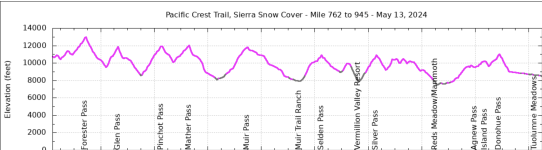

A PCT ThruHiker died of HACE/HAPE last year on Forrester Pass in 2022. The pass is 13k & is the first at high altitude. This begins the series of what we call a 'pass-a-day' as 4 - 12k peaks & multiple 11Ks follow & we plan hiking each one in a day. We begin at the base & hike over the pass & set up for the next day with overnights between 8-9k. I did them in 2019 & encountered a few who had to descend to recover. Once you pass Forrester, there's only one easy exit off the trail to lower elevation.
