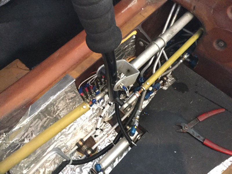

I recently had occasion to partially rewire my G205 Stick Grip due to broken wires (see this thread). When I went to purchase some rosin core solder on Amazon, I discovered that there are several available alloys with several different kinds of flux. I used to be an electronic technician in another life so I was embarrassed that I didn't know about solder any more (if I ever did); I just used what the tool crib gave me - Kester "44", I think it was.
The European Union really screwed us over with their RoHS, which banned lead in many products. I won't go into that disaster, but thankfully we can still buy the tried and true 60/40 and 63/37 solder on Amazon. The 63/37 is "Eutectic" solder and melts at the lowest possible temperature and solidifies without going through a "plastic" phase. This theoretically gives you a better joint, so I jumped the gun and ordered some made-in-china 63/37 before I did the research on fluxes. I have no idea which flux it contains.
Flux cores can be Rosin (RO), Resin (RE), Organic (OR), Inorganic (IN), and RA (Activated Rosin). They are further rated according to the residue activity (L=Low or none; M=Moderate; H=high). So for example, a Rosin Core, Moderate Activity flux would be classified as ROM0 or ROM1, depending on Halide concentration per J-STD-004. There are also different core sizes: 50, 58 and 66 = 1.1%, 2.2% and 3.3% flux. Yeah, I really don't want to know all this stuff either, I just want to know what we should be using on our planes.
In the G205 thread (linked above), I found several 26 GA wires in my stick grip hanging by a thread. When I went to make repairs, several more wires just broke off where the insulation starts. Could this have been due to using a too-agressive flux ten years ago when I wired up the connections? Improper stripping? Or maybe it was just the vibration after five years in service. I'll never know but I was careful to properly restrain these small wires this time around.

1. 26 awg is pretty thin.
2. Put shrink tubing over the wire first, slide it away from the solder joint, then solder. Slide the tubing back over the solder to no-solder region, heat and shrink. This will give some mechanical support to keep the flexing to a minimum, just like a good crimp.

When you solder a stranded wire, the soldered portion becomes solid while the rest of the wire remains stranded. That solid/stranded location is the weak point since the strands flex while the solder doesn't. That makes it very susceptible to vibration failure, something a stranded wire alone is not. The more vibrations that location is subject to, the sooner it will fail. This is especially critical if you solder two stranded wires together instead of crimping them.
If you must use solder, then you must provide that solid/stranded point some kind of mechanical support. For small wires the most common support is a piece of heat shrink that extends well into the stranded wire portion. All "professionally" soldered headset jacks will have heat shrink on the wires. An optional method is to use some kind of "clamp" on the wire, again extending into the stranded wire portion which is not an easy task to do. FWIW in the few places I had to solder wires together I used "Solder Sleeve" to provide the mechanical support beyond the stranded portions of the wires. 12 years later and I haven't had a broken wire, yet.

I think that makes a lot of sense and the same applies for crimped connections. Yesterday I tried to make a crimped connection in a very difficult place: It was dark, access was limited, and I really couldn't see very well. The crimp came out bad and I had to re-do it. The second time I just soldered the two wires together and put heat shrink over them. I could get the soldering iron down in there but not the crimp tool. It was down in here:

Another reason to solder is that butt splices for 26 AWG are hard to find. Aircraft Spruce has them 26-20 AWG TIN PLATED HEAT-SHRINK BUTT SPLICES but you really need a high-dollar crimping tool to properly crimp them. I had neither on hand in my hangar. In speaking with Ray Allen yesterday, they now offer a G405 stick grip which is pre-wired so the user doesn't have to solder those tiny wires.
