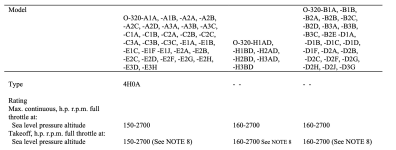

There is a good bit of history on tach time that spreads across the engine industry. Engine ratings (generally) were max power and continuous power. The difference was primarily lower rpm which was piston speed in ft/min, and BMEP or in aviation is manifold pressure. For the Lycoming that is roughly 2700 rpm and 2500 RPM. The tach was mechanical so hours were really revolutions, and an hour was at "cruise" or "continuous" RPM or about 2500. With EFIS managing this it is what you say it is. And that was always the case with engine manufacturers - it is what they say it is. Uninteresting answer, and not definitive, but relates to the general confusion about tach time.
Just to be clear, for most (if not all) normally aspirated Lycoming engines, max continuous power is full (100%) rated power.
For example, note this clip from the FAA TCDS E-274 for the O-320 series. Max continuous power is 150/160 hp at 2700 rpm, which is full (100%) rated power.
