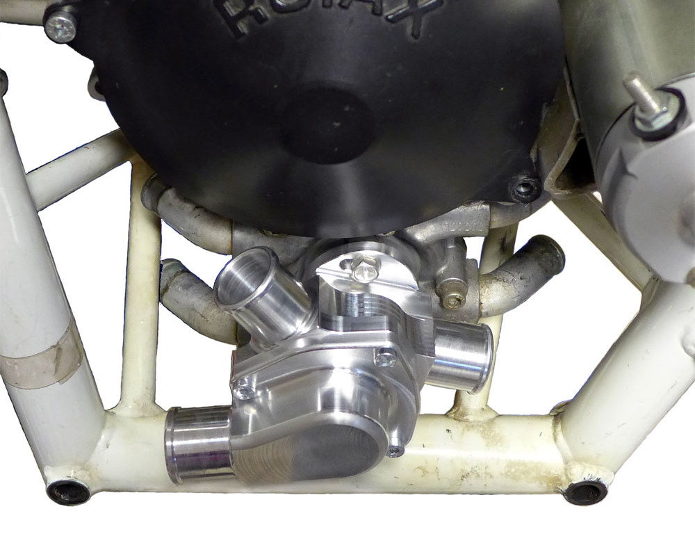

I have a thermostat-mixer from Silent Hektik im my current plane and like it al lot. There is no warming up and always perfekt temps on oil and water. No problems in almost 200 hours.
So I will put it in my current built, the RV-12iS. It will go in the next week and I can post pictures and data if someone is interested.
https://www.silent-hektik.de/UL_912_Thermo.htm

cooler question / real live temperatures RV-12iS
Like mentioned earlier I am intending to use a SilentHektik F1204 mixer thermostate with my 912iS. Yes I know the pros ans cons, but it workes like a charme in my Savannah-S. So I would like to have it in my RV too. The biggest hurdle is that the water cooler has to be able to take the additional load from the missing oil cooler. The original Rotax cooler can usually do this on most 912ULS instalations and if not the sport-cooler with 2 more rows will do. But no Rotax cooler will fit the RV-12iS. I just found out the left water outlet is interfeering with the exhaust pipe. The Vans cooler is coustom made and has both outlets on the south end of the cooler. Does anyone know if this cooler has enough reserve to take 25% extra load? How does it comparee to stock Rotax cooler? Real life climb out themperatures of a 912iS RV-12 could help calculate. The additional load should add about 35F. Any ideas?
