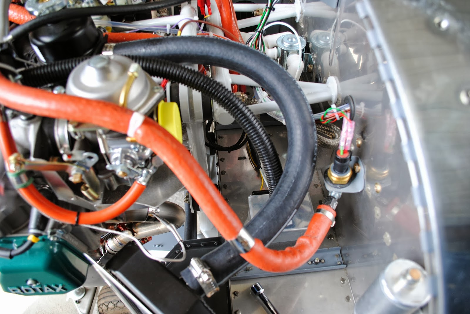

Interesting. While I am aware that the use of FireSleeves is good practice, I believe that our Cessna also had only rubber grommets. Actually, it appears as whether Van's also uses them in their instructions: https://www.vansaircraft.com/pdf/revisions/RV-12/Section_46.pdf
This 912 installation seems to be in accordance with Van's instructions, actually using a rubber grommet: http://2.bp.blogspot.com/-1ccR8HwnaUI/UkgzGaKuI6I/AAAAAAAAILE/Kl_z_fZIAb0/s1600/DSC_0002.JPG
I have to admit that I thought the Viking RV-12 installation looks really clean and am trying to distinguish between serious concerns regarding the engine package and what is only room for improvement.
