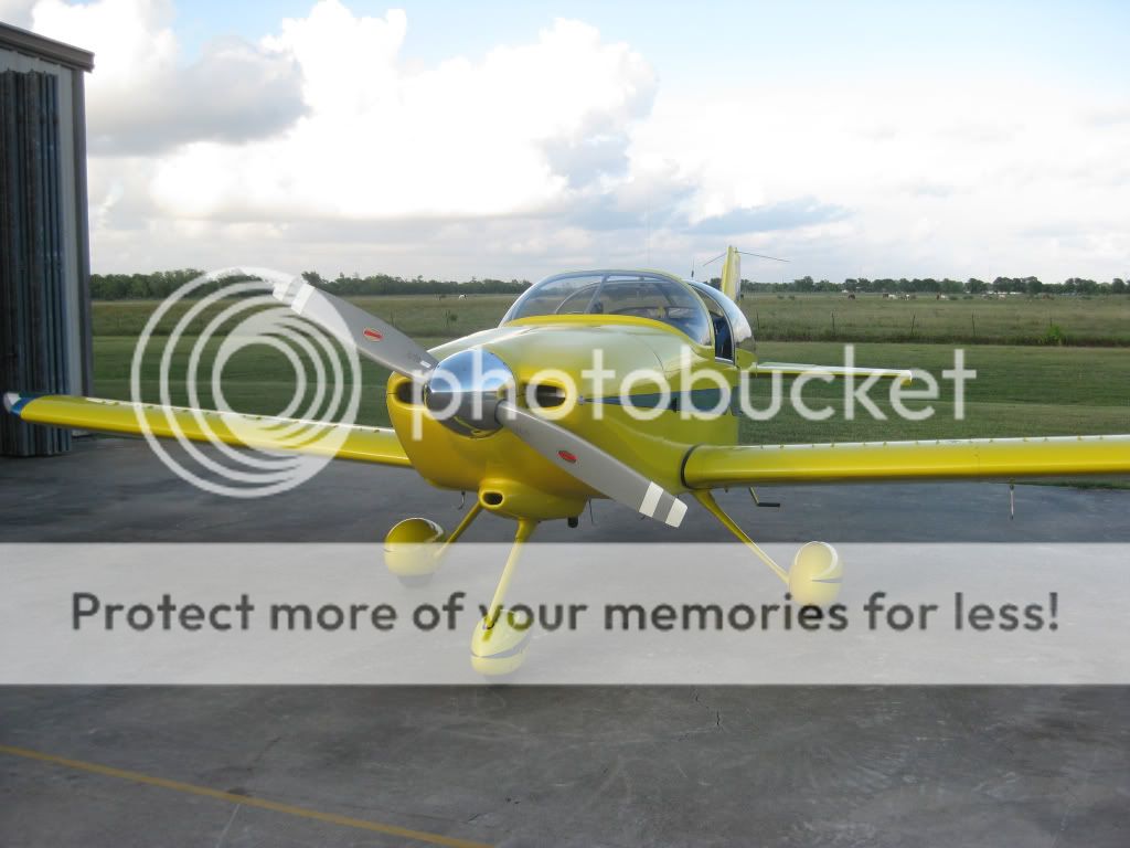

Have VGs
I have VGs. They were installed when I bought the plane. Every pilot asks me what is the result and I don't know, it came that way! Maybe Mr. Orndorf can comment on their effect. Do you have a specific question?

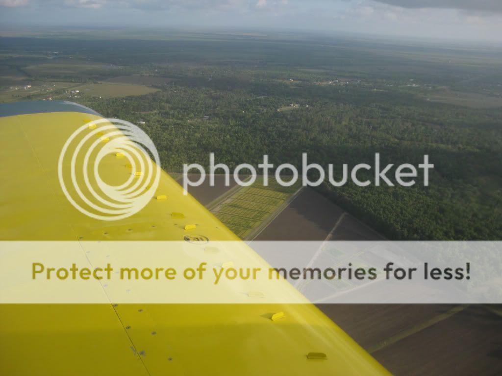

I've heard Larry Vetterman was working with someone experimenting with the VG's. I was and could still contaplate putting them on mine......if I ever get close to finishing:( From what I believe if they were installed the best place to put them would be in front of the ailerons.
Especially on the RV-6 or any of these while the wing drops from the stall the VG's would at least give better aileron control for roll effect.
Obviously stop the stall and opposite rudder as needed but the VG's over the aileron area would give faster airflow over that part of the wing to give roll recovery sooner. Or you might have roll control while the inboard part of the wing stalls.

I can not speak for the RV-12. The builder of my RV-8 tested VGs. He concluded they did not improve the handling. He removed them after only a few weeks.

Ailerons don't come into play during a stall. Leave them neutral, and PUSH... PUSH. When the wing is no longer stalled, ailerons will come back into play.
During your next BFR, as you enter a demo stall, and a wing drops, try lifting it with the aileron and see what the instructor does. Do this only with an instructor.
